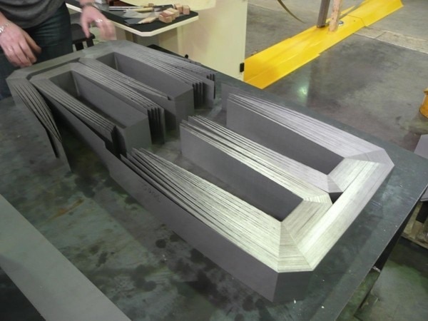

The system consists of solid tiles, of varying thicknesses. You can make various product variations: from 0.5 to 0.35 millimetres, but you can also find another sheet of thickness. Cold-rolled and hot-rolled variants are distinguished by improved magnetic circuit characteristics but the assembly of the unit involves different work skills.

Devices from thin and different core plates need to be assembled-this eliminates vortex losses. They become deformed under the influence of magnetostriction on the transformer, the performance is decreased, high-quality power measurements and other technological features are impossible to carry out.

    The cores are constructed from thin laminated sheets (of silicon steel) to prevent circulation currents (eddy currents) which cause heating and energy loss within the core, decreasing the transformers…

    Transformer core is engineered to reduce eddy current loss, since the wide cross-sectional area with lower resistance which causes the more eddy current with heat loss and unnecessary heat enables total output to be lower than customer planned. Such eddy currents are minimized by laminating the core and isolating the lamination with a coat of varnish. Here is an additional source on transformer cores which might help.

    The cores are constructed from thin laminated sheets (of silicon steel) to prevent circulation currents (eddy currents) which cause heating and energy loss within the core, decreasing the transformers efficiency.  Here is a link to a good article on this subject:
