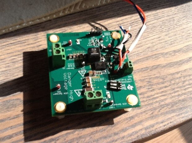

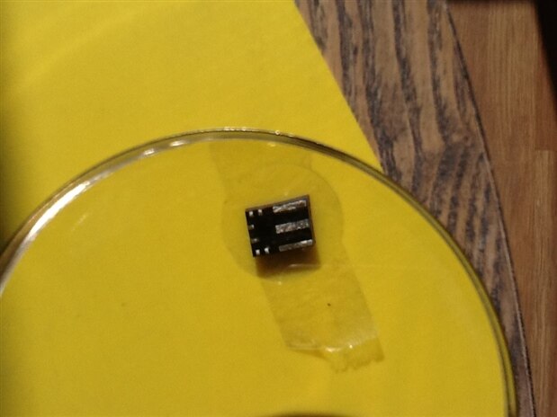

The GaN evaluation kit I have here at home died because of a power disruption @Cumps Castle.
There was a power failure in the perk of Brussels where I live. Power dropped from 240V to 110.
And here's the rub: I was providing the different voltages to the evaluation board from two different power supplies. The big power from a supply that takes virtually any input voltage between 100 and 250V.
But the bias power came from a supply that's 220-240V only.
TL;DR the LMG5200 power driver on the board didn't survive this (as documented in its datasheet).

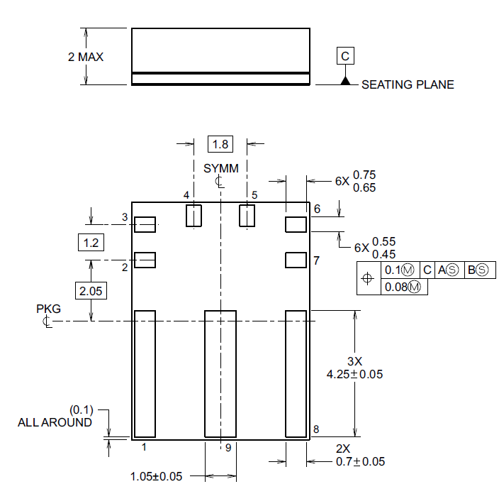

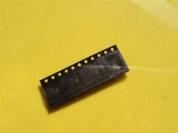

That chip comes in a QFN package. This is my first attempt to replace such a package

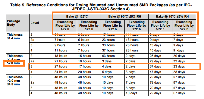

Baking the Chip
From the datasheet:
13.1 Package Information
The LMG5200 device package is rated as a MSL3 package (Moisture Sensitivity Level 3). Please refer to
application report SNOA550 for specific handling and process recommendations of a MSL3 package.
If we than check that report (our package is MLS3, 2mm thick), we're in for a long baking time.
I didn't bake it that long.

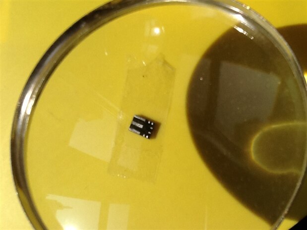

I used my microwave/combi oven - in the non-microwave mode - at approx 120° (all temperatures in Celsius) during 4 hours.
And I crossed my fingers.

I'm using an Aoyue Int 968 A+  rework station. For this exercise, I used the hot air part only.
Since there are no pins on QFN packages, there's little use for a soldering iron.

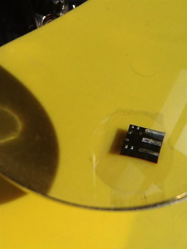

The evaluation kit uses lead-free solder. And the LMG5200 is in the way of the heat path.
That means that you have to apply the heat to the package, and that in turn will transfer that heat to it's solder pads.
I bombed the thing with 330°, low air plow - I couldn't risk that all the surrounding parts would fly away.
It took good 2 minutes before the solder melted and the IC could be removed.
This video is unavailable.

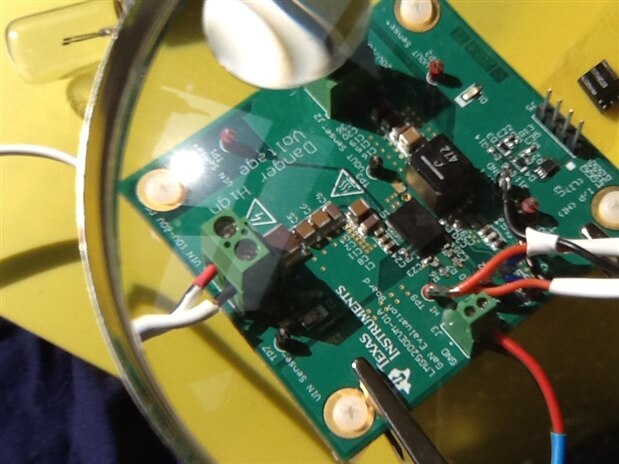

Solder Time
To avoid that I have to heat the pads with the new chip in place, I first pre-heated the area around the board with hot air for a few minutes.
I had the temperature set to 120°.
I then applied solder paste and put the IC in place, as good as possible.
That wasn't really easy because you don't see the pads, and the PCB didn't have an outline drawing for the chip.
So I placed the IC where I thought it would cover the right pads with the right pins, and pulled out the hot air nossle again.
After again a good 2 minutes, the chip pulled itself to the right position (the magic of reflow).
I let the whole thing cool down, and checked with my multimeter if there were any short-cuts.
When that test gave good results, I decided to put the board to the test. I powered it on and validated the circuit at the key points.
All behaves normal, and I consider this little project a success.

    I am presuming you needed to bake these because they were not in a hermetically sealed bag? One of the more interesting things at element14 Distribution at Leeds was the attention to detail for moisture…

    If I understand the baking process then a simple toaster oven would suffice.
    Jan Cumps over 10 years ago in reply to mcb1
    A toaster oven is ok. You can even bake at 45° C. It just takes longer.
    This application note documents the required baking times for 45, 90 and 125° C.
    It has more info about this subject than just the baking profiles. It's an appnote worth reading.

    Jan Cumps over 10 years ago in reply to clem57
    No, the cover is cured. But these type of chip has cavities that can contain humid air.
    if that stays there, the chips can explode diring the reflow process. So you have to dry out the humidity. By slowly baking the chip, you take care that all liquid vaporises and there are no humid pockets left.
    You can then immediately use the ICs, or store them in a way that there's no chance for humid air to re-enter the intestines of the chip.
    These strange cards that you find packaged with this kind of ICs discolors depending on how much moisture the IC has been exposed to after baking.
