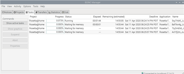

Just so I can link it to the right spot for people trying to get it going here is the instructions.
anyone wanting to run rosetta on their pi with Raspbian 64bit this will get you setup we have to set raspbian to be 64bit and then set boinic manager to accept 64bit.
open terminal  ctrl+alt+t
type:
sudo apt-get install boinc-client boinc-manager
let that install(shortcut will be under pi icon -> system tools-> boinc manager(fyi)) then type:
cd boot
(backup your config.txt file if you like with:  sudo cp config.txt config.old)
sudo nano config.txt
scroll to the end and enter
arm_64bit=1
to save and exit
ctrl-o
ctrl-x
type:
sudo reboot
type:
uname -a
you should see the following-------------------------------------------------------------------------------->v
Linux raspberrypi 4.19.113-v8+ #1300 SMP PREEMPT Thu Mar 26 17:04:40 GMT 2020 aarch64 GNU/Linux
then type
cd /etc/boinc-client
sudo nano cc_config.xml
Then add the options:
<options>
  <alt_platform>aarch64-unknown-linux-gnu</alt_platform>
</options>
you should have something that looks like this.
This is a minimal configuration file cc_config.xml of the BOINC core client.
For a complete list of all available options and logging flags and their
meaning see: https://boinc.berkeley.edu/wiki/client_configuration
<cc_config>
  <log_flags>
    <task>1</task>
    <file_xfer>1</file_xfer>
    <sched_ops>1</sched_ops>
</log_flags>
<options>
</options>
</cc_config>
to save and exit
ctrl-o
ctrl-x
Then type:
sudo systemctl restart boinc-client
You should now be able to run rosetta at home on the pi4 raspbian
and get some jobs starting instead of errors.
make sure to join the team here https://boinc.bakerlab.org/rosetta/team_display.php?teamid=19110

  • cstanton
    cstanton over 6 years ago
    Unfortunately I cannot get this to work.
    Boinc keeps insisting that it's trying to run on
    arm-unknown-linux-gnueabihf
    Rather than aarch64-unknown-linux-gnu
    Is there a step here I'm missing?
