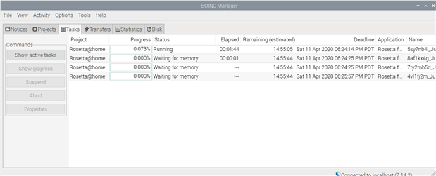

Just so I can link it to the right spot for people trying to get it going here is the instructions.
anyone wanting to run rosetta on their pi with Raspbian 64bit this will get you setup we have to set raspbian to be 64bit and then set boinic manager to accept 64bit.

Then type:
sudo systemctl restart boinc-client
You should now be able to run rosetta at home on the pi4 raspbian
and get some jobs starting instead of errors.

  • cstanton
    cstanton over 6 years ago
    Unfortunately I cannot get this to work.
    Boinc keeps insisting that it's trying to run on
    arm-unknown-linux-gnueabihf
    Rather than aarch64-unknown-linux-gnu
    Is there a step here I'm missing?
