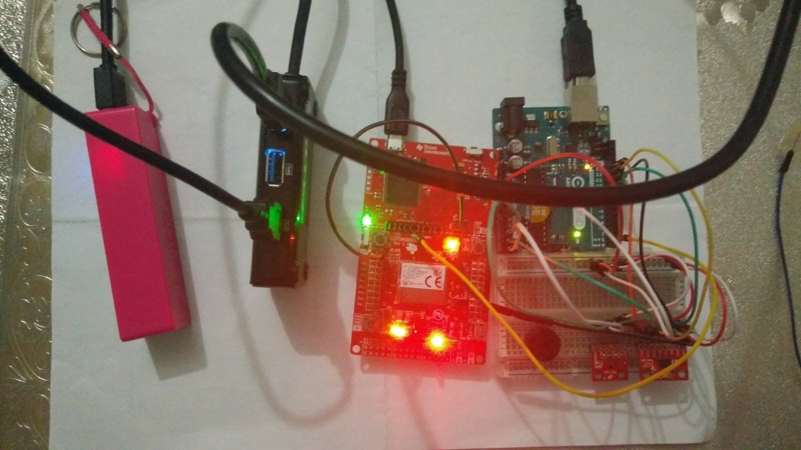

In the last post, I have mentioned the sensor board I built on Arduino. I was testing the system using the serial port and before adding many sensors, I wanted to make the board work independently. Therefore I connect MSP432 and Arduino using the serial port and send the data over WiFi module. I am using TI-RTOS on MSP432 so I add the UART driver to the previous WiFi code. The echoFxn basically echoes the serial data over WiFi. The data is read and assigned to Mymessage variable. Then task sleeps a second.

The image below shows how the system can work independently from the computer. The purple box is power bank and distributes power to MSP432 and Arduino via black USB multiport. The image is not clear but this is not final I will try to embed these inside the helmet.

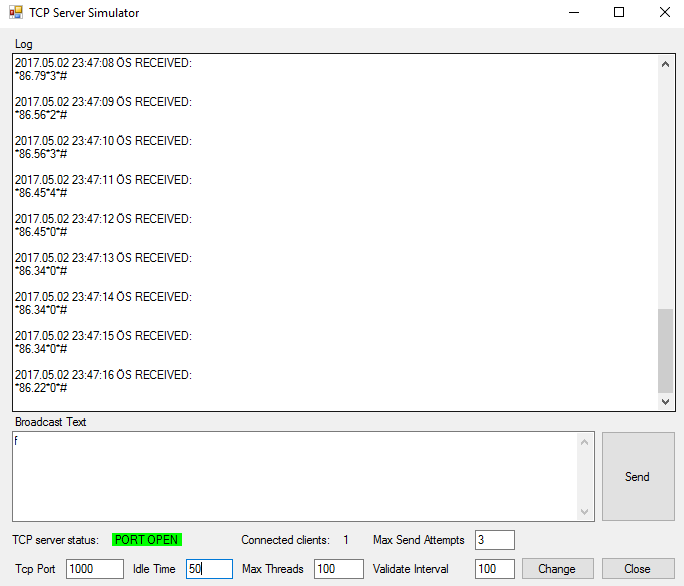

The following C# program gathers the data. It is not my code any TCP application will work for this application. I have my own code but it won't show the raw data. It will show only warnings and general info.
I have ordered an MSP430 for NFC communication. It will control the gate and send data to the computer via serial port. All the information will be seen on C# program. Next, I will work on RSSI strength to track the user and combine that information with the accelerometer.
