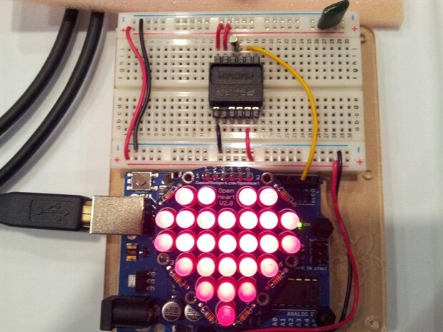

I've now connected it and a Polar chest strap receiver chip to an Arduino:
By combining source code from the Heartspark and Open Heart, a heart beat animation is played each time a pulse is received:
The receiver chip is a Polar RMCM-01:
http://www.sparkfun.com/datasheets/Wireless/General/RMCM01.pdf
It is the same chip as used in the HeartSpark and works with the Polar WearLink 31 chest strap:
http://www.amazon.com/Wearlink-31-Transmitter-by-Polar/dp/B001J8W5N2

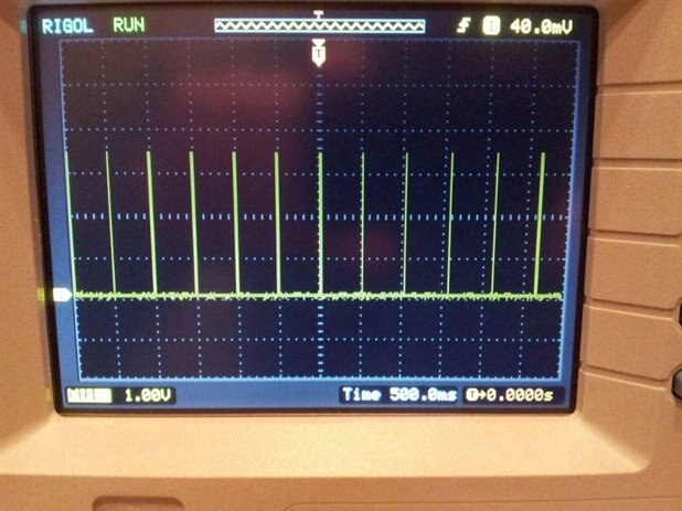

The receiver chip simply outputs a 3V 1ms pulse for each heart beat detected.  My scope shows a pulse about every 1,000 ms when sitting which translates to about 60 bpm:

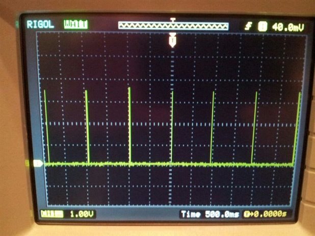

After doing some push-ups, the time between pulses cuts in half which indicates my heart rate has nearly doubled:
The Arduino code prints out the BPM and microseconds since previous pulse, and I found it matches what I observed on the scope.   Although I think the code still needs some tweaking, especially for edge cases.  I've attached the current version to this blog post.
