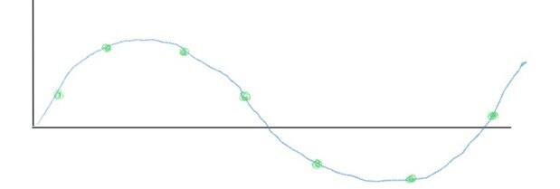

Essentially, the scope is sampling an incoming waveform at various points once it has triggered.  These points are then joined to reproduce the waveform on the screen - rather like a dot-to-dot picture:
(excuse the crummy picture) It doesn't take much intuition to work out that the more samples it can capture, the more accurate the waveform displayed will be.  The Siglent will interpolate these samples (join the dots) using a Sin(x)/x or x  algorithm (curve or straight line) but this can still only work with the samples it has:

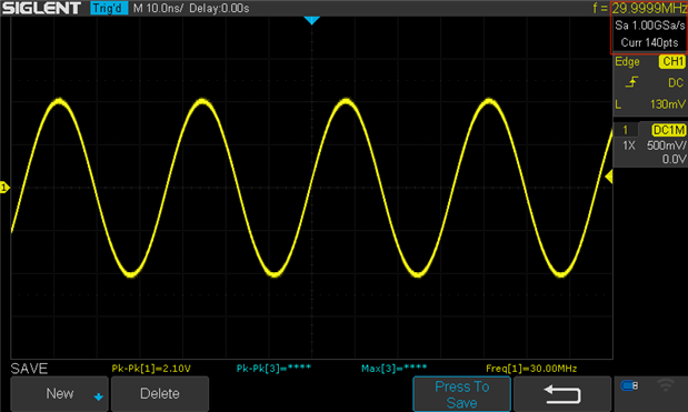

This is the easiest to test so I’ll do it first.  I calculated above for a 10ns timebase at 1GSa/s the scope would be able to capture 140pts of data.  And so it goes:
30MHz waveform at 10ns timebase and 140pts gives 140ns of captured data:

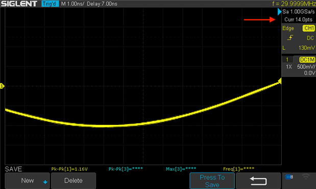

And at 1ns it should use:
Memory Depth = 1,000,000,000 x 0.000000001 x 14 = 14 points.
Giving me 14ns of data:

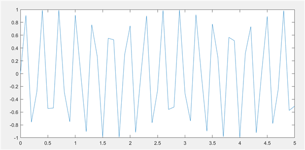

    The join-the-dots option is weird.. I don't know if my 'scope has it, it might, but I've never used it (nor sure why it's needed, because it will give a misleading representation.

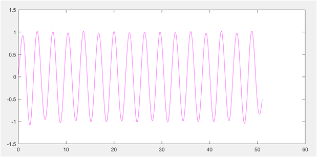

    Here's an example of join-the-dots, at a valid but low sample rate (i.e. at about 2.5 times higher than the signal input):
    This is it with sinc:
    It looks very close to the source signal, which was a sine wave. It mostly looks accurate, apart from the ends where the levels look slightly wrong.
    This would apply to any signal, not just a sine wave, provided the sample rate was approx 2.5 times the max frequency component in the input signal.
