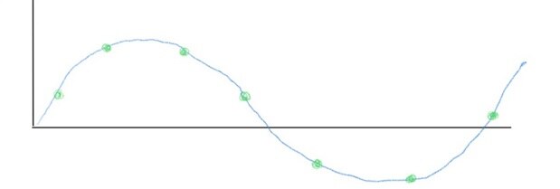

Essentially, the scope is sampling an incoming waveform at various points once it has triggered.  These points are then joined to reproduce the waveform on the screen - rather like a dot-to-dot picture:
(excuse the crummy picture) It doesn't take much intuition to work out that the more samples it can capture, the more accurate the waveform displayed will be.  The Siglent will interpolate these samples (join the dots) using a Sin(x)/x or x  algorithm (curve or straight line) but this can still only work with the samples it has:

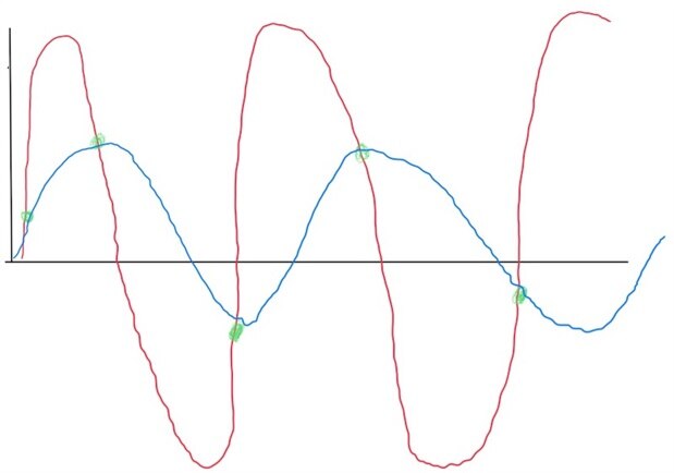

(excuse the even crummier picture)  In the image above, the incoming red signal isn't sampled fast enough and so what appears is the interpolated blue waveform.
So interpolation doesn’t necessarily result in an accurate capture or display.  In practice, when this is needed, for example trying to measure a waveform at a frequency greater than the scope is capable of, the scope should be building the displayed waveform up from samples captured at slightly different times across multiple, successive incoming waveforms in order to give an accurate image - called equivalent-time sampling.  This would require the waveform to be stable and repeating to work of course - without that, accuracy is impossible and at best you’d need to use your brain and intuition to guess what the actual waveform looks like.  It certainly isn’t going to help find glitches or other problems if the scope is working in this way.  A datasheet would refer to this as ‘Equivalent Sample Rate’, something that doesn’t appear in the datasheet for this model.

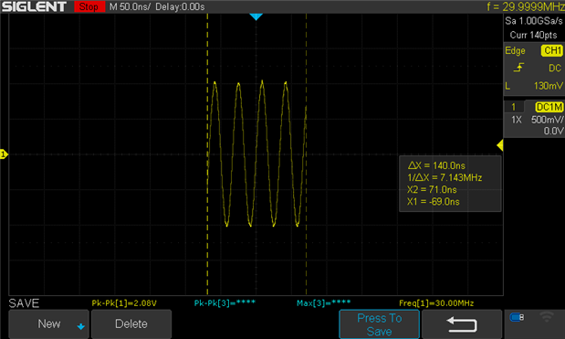

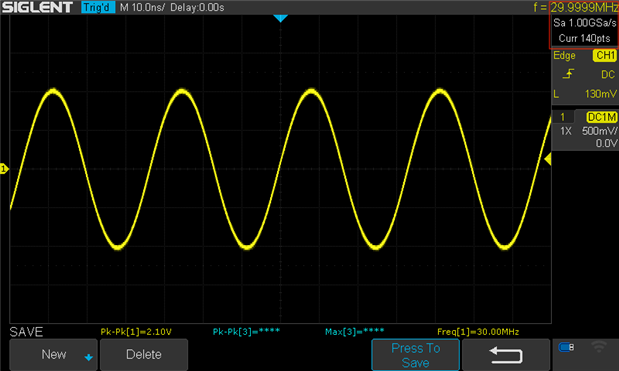

This is the easiest to test so I’ll do it first.  I calculated above for a 10ns timebase at 1GSa/s the scope would be able to capture 140pts of data.  And so it goes:
30MHz waveform at 10ns timebase and 140pts gives 140ns of captured data:

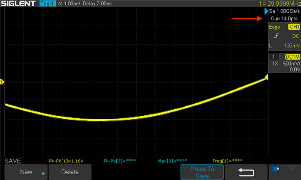

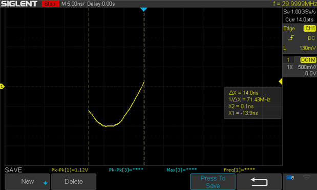

And at 1ns it should use:
Memory Depth = 1,000,000,000 x 0.000000001 x 14 = 14 points.
Giving me 14ns of data:

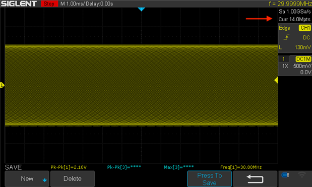

To get full memory usage, the timebase has to shift to 1ms:

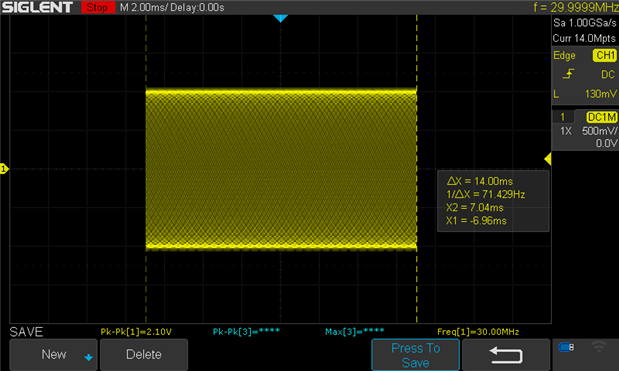

That does give me 14ms of data as calculated above:

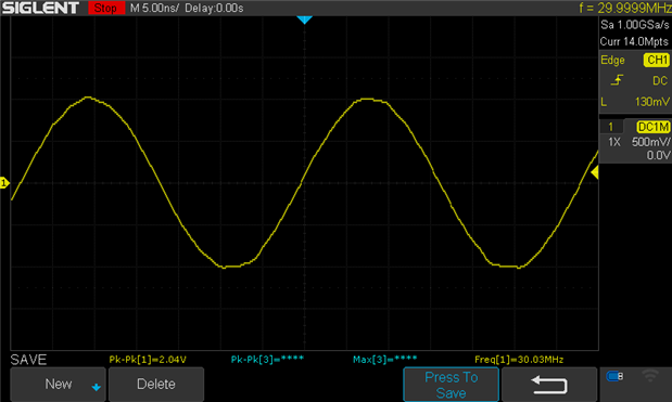

I can use that data to zoom in.  Here is the captured data at a timebase of 5ns:
Compare the above to the image 3 back which shows this signal at 5ns with the waveform captured at 1ns.
So what does that tell me - remember that I originally thought memory was used differently?  Firstly, I suppose, that it is conforming to its specification but that doesn’t surprise me; ditto the maths: it's a simple multiplication across 14 divisions.  Secondly, is that at faster timebases memory depth of 14Mpts is irrelevant because it just isn’t used - and let’s face it, faster timebases is where we are likely to be looking.  Having said that, I can slow the timebase down to, 1ms in this case, and capture a mass of data that I can zoom into, right down to a 1ns timebase as demonstrated in the last image above.  Clearly the way to use memory is to capture slow and zoom in.

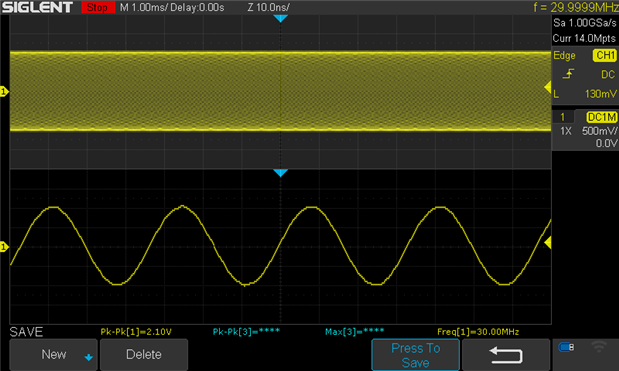

Just to re-iterate, here is the 1ms capture zoomed in to 10ns:
What might I be missing with this approach (capture slow, zoom in)?  The first is obvious just looking at the image above: at 1ms the image is essentially a blur and of no use.  I have to zoom in to see detail and 14Mpts is a lot of data to sift through!  It would seem that judicious use of triggering to identify a point of interest at a fast timebase is the way to go, slowing down for more data (just enough) once I know where and what I’m looking for.  Apart from that, I'd say that taken on its own merit, having lots of memory is a good thing - but I'll soon see the implications of that and that it cannot be taken on its own merit!

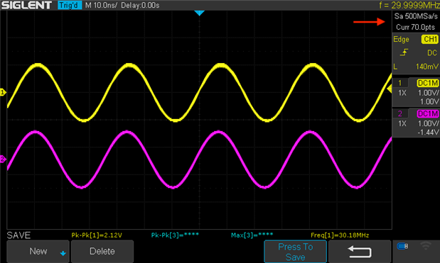

Finally, just to prove a point, here is sampling and memory usage with one channel pair in use, thus halving the sample rate and available memory.

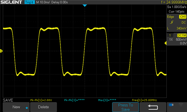

This scope doesn’t do equivalent-time sampling so there’s no testing for that.  The memory depth tests above show that the scope is maintaining its sampling rate right down to its fastest timebase of 1ns and up to 1ms.  What I can test is the implication of reducing the sampling rate on the waveform displayed.  To do that, I’ll send in a 25MHz square wave sampling at 1GSa/S:
It may not be perfect, but it’s definitely a square wave when captured at maximum sampling rate - here shown at 10ns timebase.

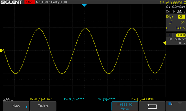

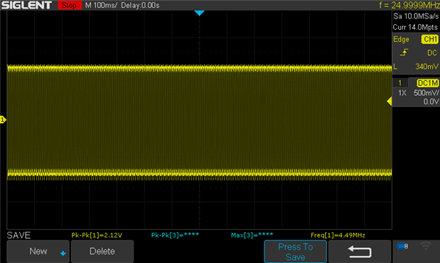

Capturing it at 10MSa/s (a timebase of 100ms) gives us a (useless) view of the signal:

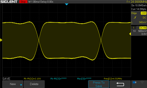

But worse to come - I’m capturing a full 14Mpts of data but zooming into that I can get down to 1ms and I have no idea what it is showing me.  What look like square waves but reflected (not my setup I don’t think, I’m  connecting with 50Ohm terminators)

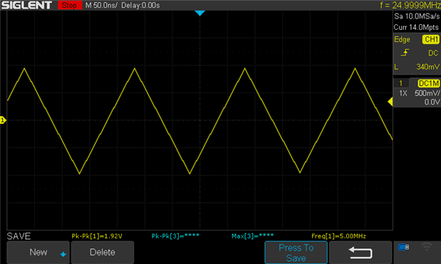

But I can get down to 50ns and see something that is completely incorrect:
It’s not possible to drill down further to a faster timebase, not that it would help.
Changing to an interpolation method of ‘X’ (i.e. join the dots with straight lines) doesn’t help either (I’ve re-captured the waveform at 100ms and zoomed in):
So without enough samples, the scope cannot properly reproduce the waveform.  This is a fairly obvious statement (it ties in to the commonly stated sampling at 2xfrequency or 5xfrequency for square waves) but it drives home the need to ensure that it’s important to understand exactly what the interplay between sampling rates and memory means for waveform accuracy.  Something I hadn’t really appreciated until now.  Here I know I'm looking for a square wave so I know something has gone wrong, but that might not be the case for a device under test where glitches and other anomalies are going to be missed.
