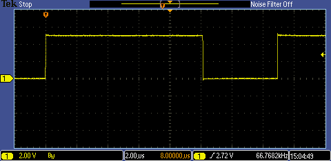

The way I knew that it was taking all of the processing time was to set an output pin at the start and reset it at the end
of the interrupt code. That's the write to PORTB that you can see in the code. Here's the scope trace, but with a longer
timer period. Bear in mind that the interrupt needs time for entry and exit too, so it was over-running the 10uS.
