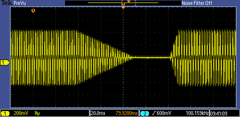

With what I've done so far, the note produced by the music box maintains the same amplitude all the way through the note.
That's quite unrealistic. With a real instrument there's always a period at the start where the sound builds in intensity,
even if it's very fast, and a decline at the end as the energy in the system gradually dissipates. The shape of the

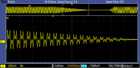

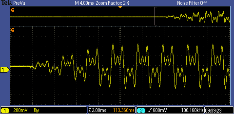

amplitude as it varies over time - what you'd see if you displayed the whole note on an oscilloscope - is called the
envelope. The period at the start, as the sound increases, is called the 'attack' and the period at the end, as it declines,
is the 'decay'.
If I want a better sounding note, I need to find a way to generate the envelope. One possibility is to do it in the
software. Another is to do it externally in the hardware. In either case, what we are trying to implement is a multiply -
we'll be multiplying the note values by the value for the envelope. There are some differences between the two approaches,
hardware and software. Doing it in software will result in a dramatic loss in resolution at the lower levels whereas doing
it externally in hardware will preserve the note shape. How much that matters I've got no idea, but doing it in software is
much simpler and easier to try so that's where I'll start.

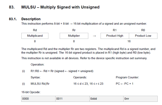

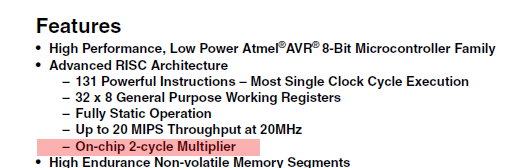

Originally, I assumed that the microcontroller wouldn't be able to do a multiply within the time between interrupts -
multiplying with a software library is time consuming -  however, my assumption was wrong - looking at the microcontroller's
datasheet I realised that it has a built-in 8-bit hardware muliplier that can produce a result in only two instruction
cycles.
The actual instruction I'm trying for is MULSU which multiplies a signed 8-bit value by an unsigned 8-bit value for a signed
16-bit result.
The signed operand will be the waveform data and the unsigned one will be the envelope value at that moment in time. The
result I'll mangle a bit to give an 8-bit unsigned value to send to the DAC port.
First problem, though, is that I'm programming it in C, and not assembler, so how do I make the compiler use the multiply
instruction I want? Is it clever enough to use the instruction when appropriate or will it always use some multiply routine
instead. I'm going to try casting the operands and the result to the appropriate forms and look at the timing to see what is
happening. Much to my surprise, that seems to work - I have an envelope and it still completes easily within the timer
interval.

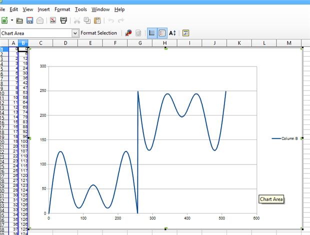

Reworking the Wave Table
The second issue is that the waveform data is currently 16-bit unsigned. I could manipulate that, but I've chosen instead to
rework the code that generates the waveform table so that the table contains signed char values that can be directly fed
to the multiply. Here's the code for that.

One difference now is that if you graph the values with a speadsheet program it will look something like this - the left
half is the positive values (coming up from zero) and the right half is the negative values coming down from the maximum
value (which is one less than zero, ie -1).

Waveforms
Here's a scope trace showing the end of one note and the start of the next:
Here's the start (the 'attack') in more detail.
Here's the end (the 'decay') in more detail. That's fine too. So, it looks like I've gotten all the signs and the

    It's very easy to do with the code. First a look-up for the modulation, then the result gets added to the step size for the tone look-up. Took a couple of minutes to get it going.
    It's going to be interesting to experiment with, so thank you for the suggestion - I wouldn't have thought of doing that myself.
    Jan Cumps over 8 years ago
    If you want to use the assembler instruction, here’s a series of tutorials to inline some instructions in the C++ code

    Thank you Fabio - that's useful. I did wonder about trying to in-line the assembler, but it felt like it might be a steep learning curve - I'm not that familiar with gcc (nor with AVR assembler).
