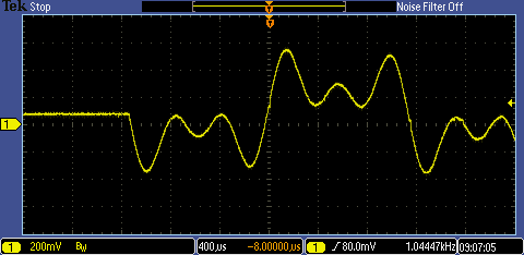

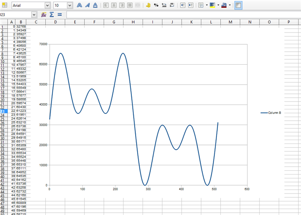

First example: fundamental and just the 3rd and 5th harmonics. This will be fairly mellow.
float harmonicTable[10] = {1.0,0.0,0.9,0.0,0.8,0.0,0.0,0.0,0.0,0.0};
That produces this waveform in the table
looks like this at the loudspeaker terminals
and sounds like this

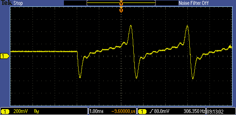

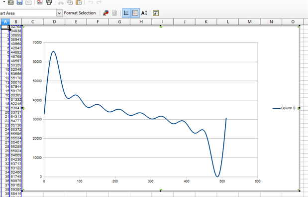

Second example: fundamental and lots of harmonics, gently tapering off. This will be harsher as a sound.
float harmonicTable[10] = {1.0,0.9,0.8,0.7,0.6,0.5,0.4,0.3,0.0,0.0};
