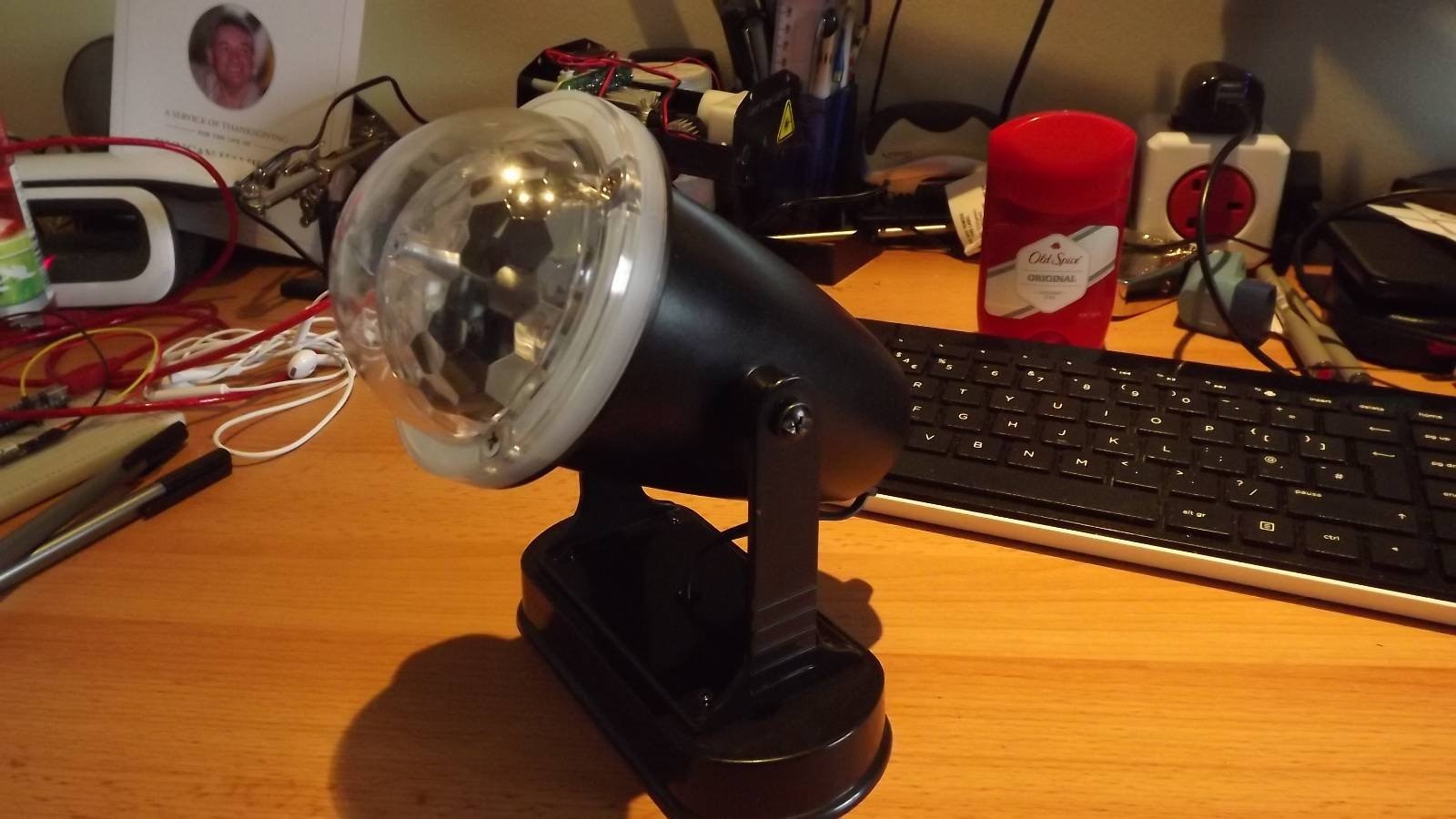

I decided today to try and work on the programming for the Party Ball. I had already written a c++ program to decode the MQTT messages and am using the LED Controller from MK Smart House as a basis for the code.
I wanted to keep the MQTT commands relatively simple, and easy to decode in software, this is the list I decided on. I am also going to try and keep this standard throughout my projects using my openhab server to try and keep things simpler.

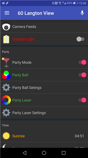

Openhab Configuration
Items
//Party Ball Controls Switch
Party_Ball   "Party Ball"                 ["Switchable"]
Color  Party_BColor "Party Ball Colour"
Dimmer Party_BSpeed "Party Ball Speed"
Switch Party_BAuto  "Party Ball Auto"
//Party Ball Commnad String
String Party_BCom   "Party Ball Command"  {mqtt=">[broker:DF/Party/Ball:command:*:default"}
For the items associated with the party ball I created several different items.
  • Party_Ball : the power button
  • Party_BAuto : Auto mode for the Party Ball
  • Party_BColor : For setting all the neopixel Colours
  • Party_BSpeed : the motor Speed of the kaleidoscope
  • Party_BComm :  the command string sent to the device
I used a seperate string for sending the commands as to not have to mess around with mappings for the MQTT binding in openhab, as it would have made making modifications to commands harder. It also would not have allowed me to send the colour value as RGB as openhab stores the colour as an HSB value. So all of the commands sent to the device are constructed using rules
Sitemap
Switch  item=Party_Ball     visibility=[Party_Time==ON] labelcolor=[ON="green"]//Party Ball Settings
Text    label="Party Ball Setings"  icon="settings"     visibility=[Party_Ball==ON] {
     Switch          item=Party_BAuto    label="Auto"
     Colorpicker     item=Party_BColor   label="Colour"  visibility=[Party_BAuto==OFF]
     Switch          item=Party_BSpeed   label="Speed"   mappings=[0="Off", 20="Slow", 60="Half", 100="Full"]    visibility=[Party_BAuto==OFF]

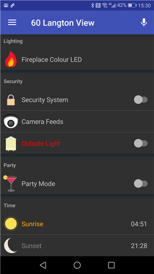

I wanted to make the Sitemap more dynamic, so the controls are hidden when Party Mode is turned off, and the settings controls are hidden when the Party ball is turned off.

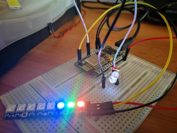

Test Circuit
Writing the code is all fun and games, but it is much better to see the results of the code in the real world. So I made up a quick test circuit using a Neopixel Strip and an led to simulate the motor (I couldn't be bothered wiring up a motor so troubleshooting the code).
They are connected to a NodeMCU ESP-12 development Board.

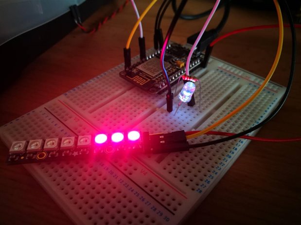

Here showing both the Auto mode on the left and (what should be) Red on the right.
I say what should be red as although in the image, it shows up more red the leds look more pink in person, the actual value sent to the device is 255,0,22. I Am not sure the reason, i may not even matter once installed in the body

    Looks great. the actual value sent to the device is 255,0,22. I Am not sure the reason I'm not the software expert here, but I suspect the error might be here. String intval = msg.substring(found +1, sizeof…

    thanks for the suggestions, I had not noticed the wrong string there, i will change it and see if it helps. But having done some testing by sending MQTT commands through a MQTT client on my computer the…

    I will also try using the map function, as i know that i didn't want to do the multiplication at the server side as it was creating a float with several decimal points, and as i discovered the input command was too long for some commands so it would have never worked that way. I mostly did the multiplication method as an afterthought, i will also probably do it for the motor speed as i have been working on that just now. As it currently accepts a percentage speed and in the analogwrite i just multiply by 10.23 to get to the 0-1023 value.
    Ill let you know if these help, thanks again
    String intval = msg.substring(found +1, sizeof(msg));
      Gval = intval.substring(0, intval.indexOf(":"));
      Bval = intval.substring(intval.indexOf(":") + 1, sizeof(msg));
    You've created a new string (intval) which has a new length, but you're still using the length of the old string (msg) to determine the end point.
    I suspect it should read
    Bval = intval.substring(intval.indexOf(":") + 1, sizeof(intval));
