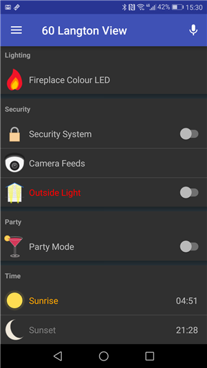

Sitemap
Switch  item=Party_Ball     visibility=[Party_Time==ON] labelcolor=[ON="green"]//Party Ball Settings
Text    label="Party Ball Setings"  icon="settings"     visibility=[Party_Ball==ON] {
     Switch          item=Party_BAuto    label="Auto"
     Colorpicker     item=Party_BColor   label="Colour"  visibility=[Party_BAuto==OFF]
     Switch          item=Party_BSpeed   label="Speed"   mappings=[0="Off", 20="Slow", 60="Half", 100="Full"]    visibility=[Party_BAuto==OFF]
I wanted to make the Sitemap more dynamic, so the controls are hidden when Party Mode is turned off, and the settings controls are hidden when the Party ball is turned off.
