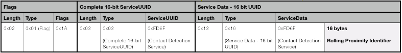

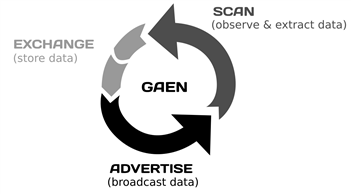

The Google and Apple Exposure Notification (GAEN) framework is quite unique in that it combines both observer and broadcaster roles with additional software to handle the periodic changing of key identifiers such as MAX address and UUID. The framework also includes other non-BLE related aspects such as cloud communication and encryption for key exchanges etc. But that is not covered in this blog.image
The new non-connectable undirected Contact Detection or Exposure Notification BLE service is registered with the Bluetooth SIG using a 16-bit UUID 0xFD6F.
The Advertising Service Data broadcasted with this service UUID contains a 128-bit (16 byte) Rolling Proximity Identifier, which will change periodically. Both the advertiser MAC address and the Rolling Proximity Identifier changes synchronously so that the phone cannot be tracked by linking previous transmissions.
Then there is another 4-bytes attached to the Rolling Proximity Identifier, which contains within a transmit power value to indicate bluetooth TX signal strength at 1 metre distance. This is used to provide better distance estimation. Of course phone location relative to body position makes this a fairly rough guestimate.

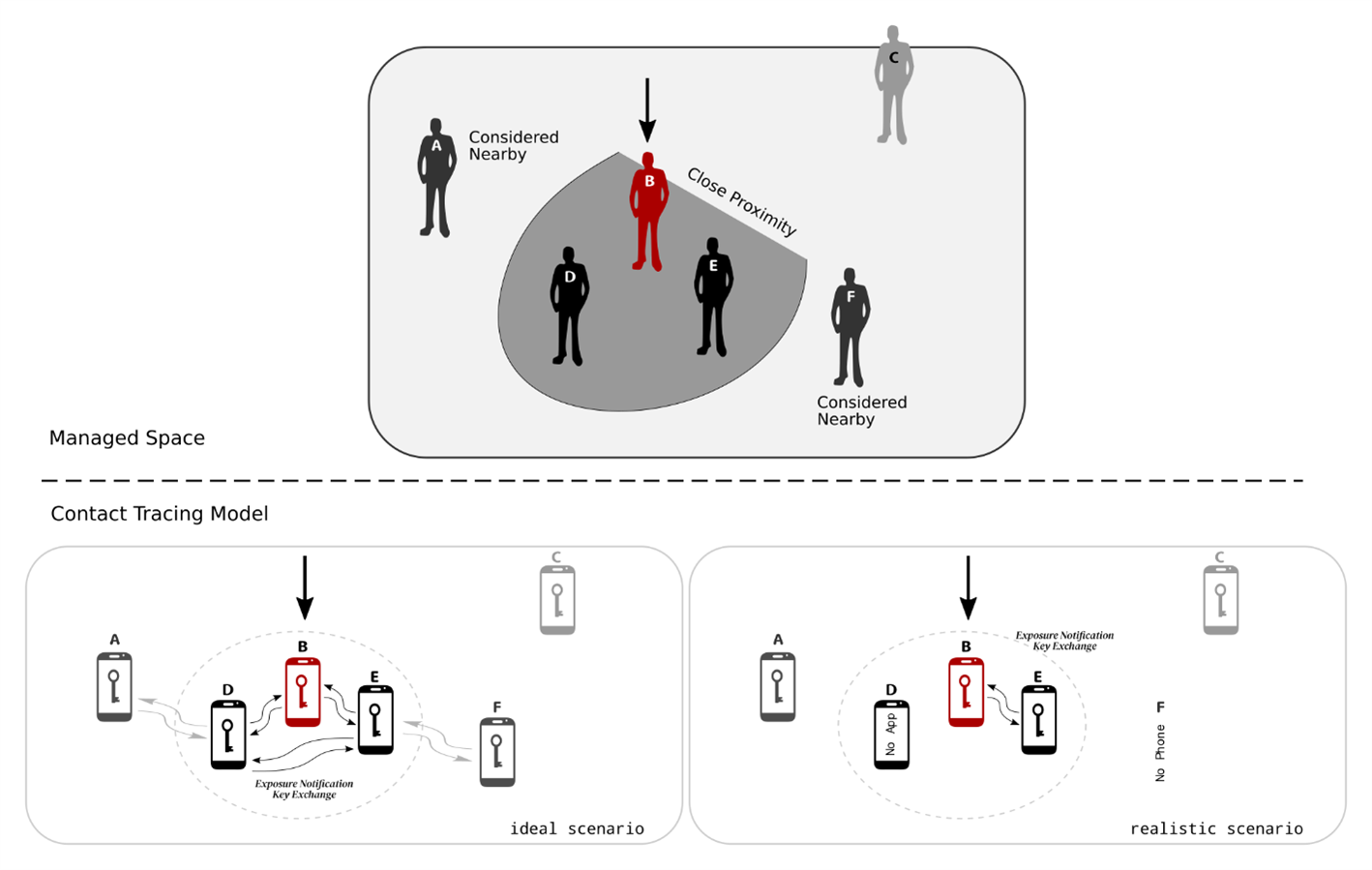

I cannot see anything fundamentally wrong with the GAEN model in theory as it is based on proven technology.
However, I did spot one news article on Forbes.com, which highlighted some asynchronous or poor timing behaviour with the rolling MAC and Proximity Identifiers. The author of the article described the observed behaviour as leaving pebbles behind so that someone can retrace your steps. Considering that the current advertising frequency is approximately 200ms, this may well be the reason why it happens occasionally. In my mind, it does not make sense having such a high frequency for advertising, especially if the app is only supposed to detect if someone has been lingering close by for an extended period of time, not passing by. You can only imagine that there is now a cacophony of BLE broadcasting “noise” created by users with this new notification service enabled, especially within busy spaces like a restaurant or a supermarket.
But there is one high level or architectural weakness with application of the overall model. This GAEN framework only works well if the vast majority of people have the Exposure Notification Service enabled on their phones. Otherwise you end up with this sort of scenario, where the GAEN key exchange is limited because someone does not have the app or service enabled or don’t have their phone with them etc. - and there are a variety of reasons for this in the real world:
As such, in my opinion, it may only deliver sporadic benefits rather than deliver a consistent universal impact. But there is scope for improvement of course and here is one suggestion.

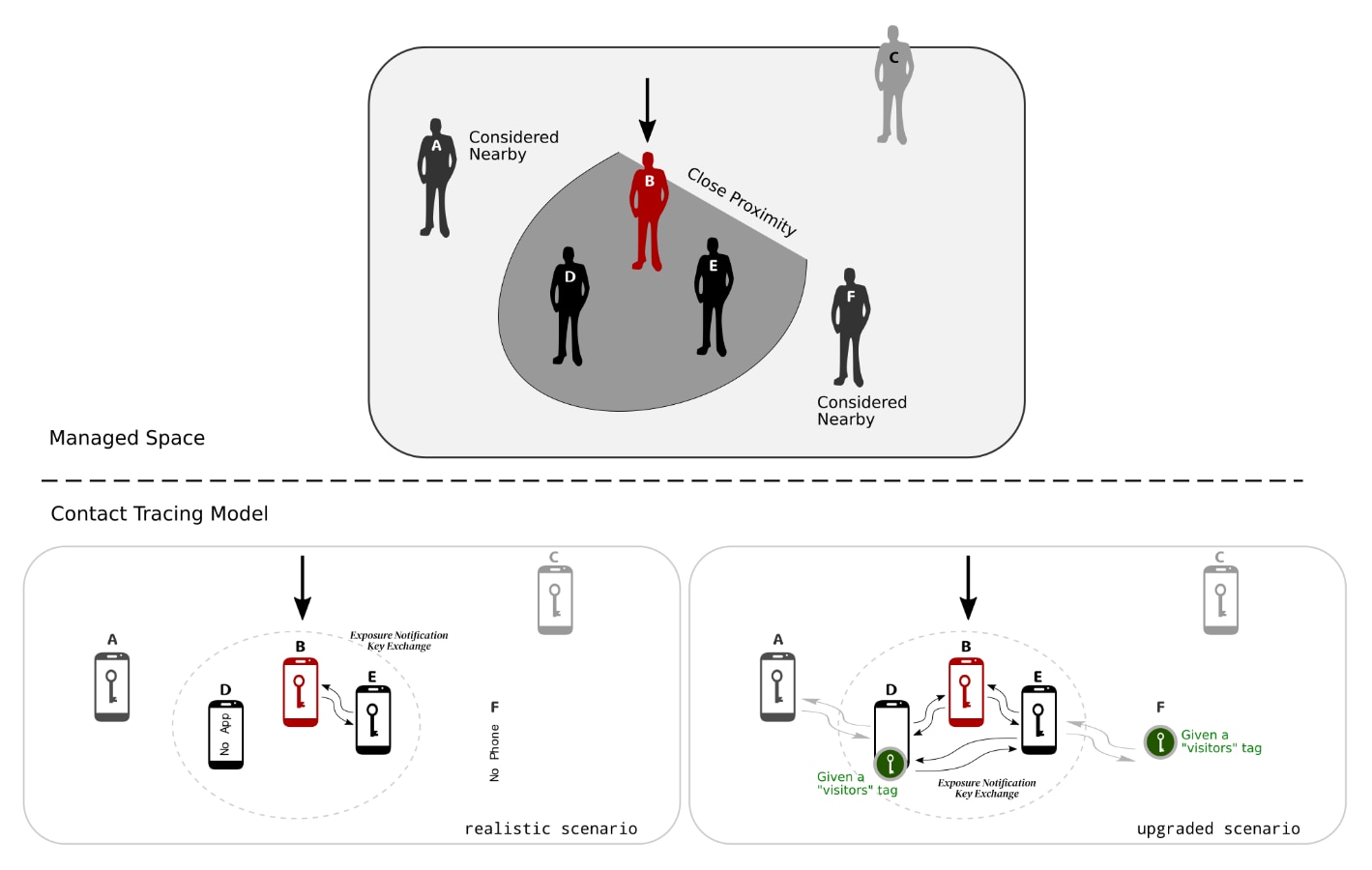

Introducing a Gateway / Boundary type enhancement
As you well know, it is in everyone's interest that the number of people entering a defined space is controlled to prevent overcrowding etc. It appears to me anyway that most managed spaces, such as restaurants and bars, have introduced various measures to control access which is aided by people counters, for example. This type of control is typically handled at the point of entry.
It should also be in everyone's interest that those entering this space can be traced should someone be unknowingly infected with the coronavirus and have come into close contact with other strangers. I have come across press reports that some managed space owners are manually checking to see if users have the Exposure Notification Service enable. No doubt they can appreciate the benefits of having these checks but doing it manually must be costly.
Now, as you know, when visiting another business premises you are required to sign in for health and safety reasons. This is typically done at the office reception desk and once you’ve manually signed in and have been vetted you are given a temporary security pass to access the building etc. The exchange of details provided means that you can be traced, should it be required.
This manual sign-in and vetting process is definitely not suitable for the general public entering into managed spaces, such as a train station or shopping centre, for example. So, the proposed Proof of Concept is to come up with a semi automated solution that provides automatic entry to those you have the Exposure Notification Service enabled and to open up opportunities to either remind those who don’t have the service enabled to enable or to provide some type of workaround, like visitors tag, for example. The logistics of how this might work in practice is outside the scope of this blog.

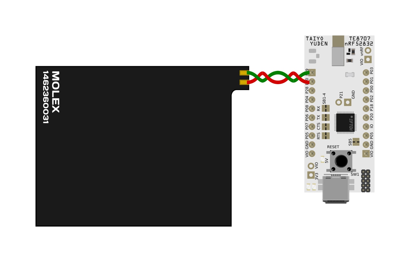

Setup
Connecting the NFC antenna to the EBSHSNZWZ board is dead simple as it connects directly onto pins P0.09 and P0.10.
To get a sense of just how small the Taiyo Yuden EYSHSNZWZ module really is, here is an image showing a class 6 NFC antenna overlaid on the development board. You could literally include the BLE module and necessary components within the confines of the NFC antenna (note the black square seen on the dev board is the FTDI chip and is not needed). That is pretty impressive, in my opinion.
Anyway, that is really it regarding the hardware - assuming that you are using a tuned NFC antenna of course. The flexible NFC antenna used in my demo came from Molex (part number: 1462360031), which was part of an antenna kit sent to me by Element14 some time back (it is proving very handy from time to time). This antenna seems to work pretty well, but I haven’t checked how well (i.e. no tuning assessment was done).

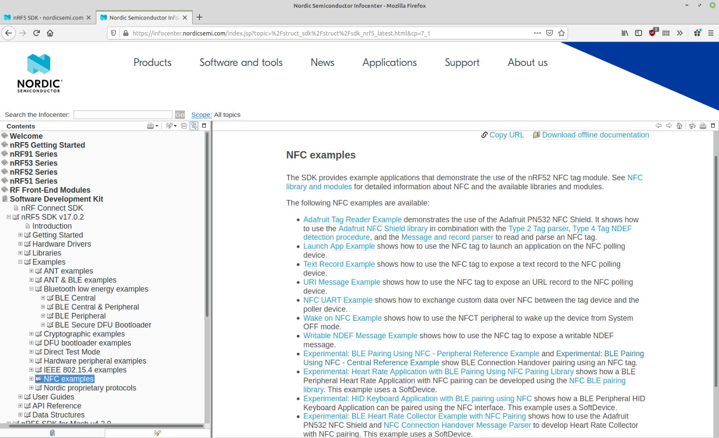

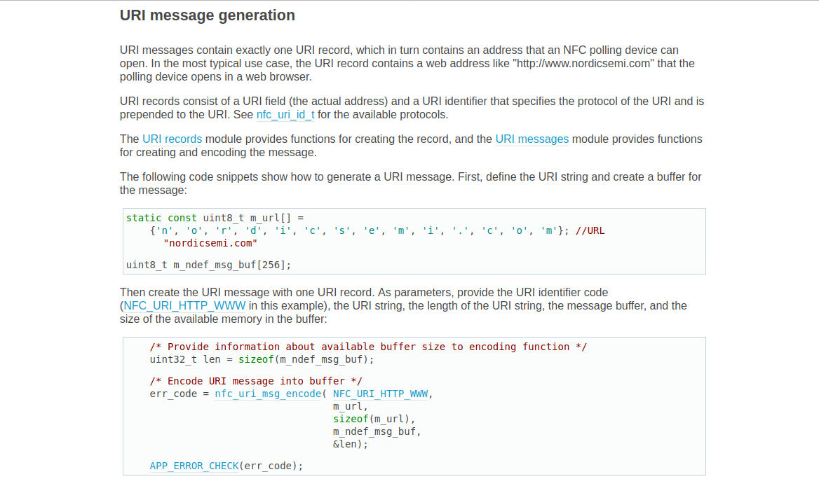

Looking at the NFC example folder, there are also some very useful examples to get started with.
The URI message example provided was exactly what I needed as it handles URI message encoding.

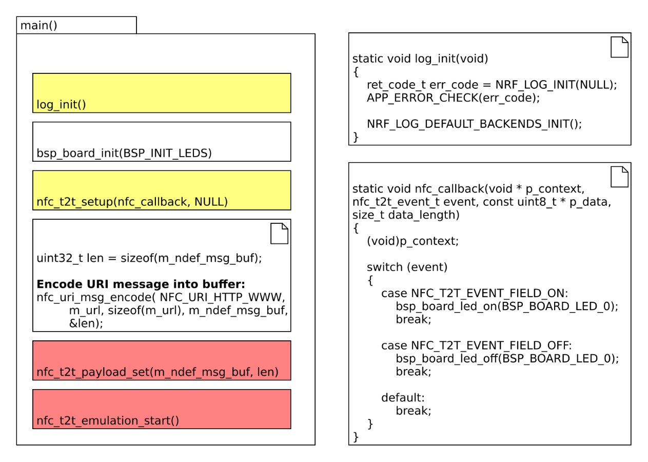

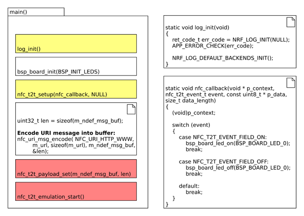

This NFC URL demo code is also pretty straightforward too. Here’s a quick overview.
The main routine includes a number of functions of which only two can be directly modified within the main.c file. These being log_init(), which is just for debug messaging and the other being nfc_callback(), which handles all the NFC events. The function bsp_board_init() is found within the “boards.c” file, which is a common library file linked to the hardware rather than the app itself. Then there are 2 other functions, nfc_t2t_payload_set() and nfc_t2t_emulation_start() which is from a precompiled nfc library module for type 2 tags (named nfc_t2t_lib_gcc.a). So we don’t get any visibility on that code.
But that is just part of the story.

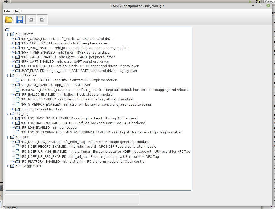

Behind the scenes, what defines which parts of a library are made available for your app and how different parts of a library are configured is all controlled via a header file called “sdk_config.h”.
This is a large config file and I discovered that the best way to view this file is to use the special tool wizard provided called “CMSIS Configuration Wizard”. You will need to use this wizard as merging the "sdk_config.h" file for NFC and the one used for BLE central takes some doing to get right.
And that’s really it for getting a NFC type-2 tag application to spit out a URL NDEF message when someone taps their phone of the NFC antenna attached to a nRF52832 or nRF52840 module.
