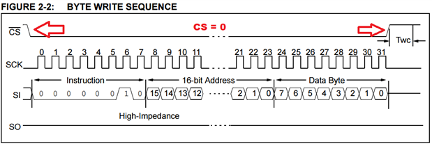

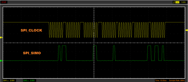

When configuring the SPI Bus HalCoGen, you have SPI_CS0 settings such as automatic so that the internal MCU module generates the control signal CS0 for enabling the external memory module 25LC256 (Microchip).
The result of this configuration, gives a signal CS, which changes state whenever the SPI (Hercules RMx) module finishes sending a byte by its bus.
in other words, send 1 byte and CS value change, this is what creates compatibility problems of Texas Instruments with Microchip series.

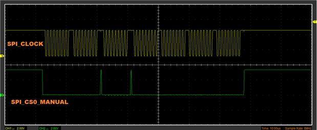

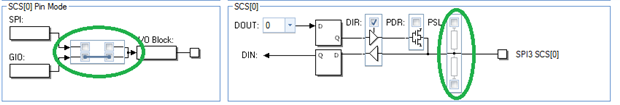

I make some changes to the configuration of the output pins, thus allowing me to my control signal CS, manually by program.
need change the configuration of CS [0], to work as a GIO
Extras configuration for the SPI module:
And

Resulting Waveform
waveform 25LC256 Datasheet (Microchip)

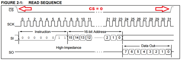

For the sequence of reading and writing, the state of CS remains low.
even after full 1Byte transmitted.
Program execution and memory read successfully!
