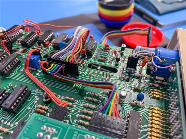

Picture 5. These ICs are on the DMM module. There I would fully expect to see digital logic being used. What caught my eye in this section is the wires. Do those look familiar to you? Let's get a better look.
Picture 6. These are wires and headers on the DMM module. I joke in the video that they are like looking at an Arduino project but in an expensive piece of test gear. At least expensive for 1978.
