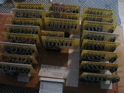

I finished the ALU (all 8 bits) and the test-board yesterday. It contains 355 transistors without the test board.
In all it took less then two days to construct and trouble-shoot (not including the small boards).
It is interesting to note that the ALU only had one short while the test board had two LED's soldered in backwards and a short.

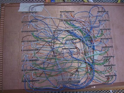

The back side of the ALU;
The 34 pin connector is wired as below;
The six functions are not encoded so if more then one is selected at a time the functions are calculated and the the results are OR'd together
(I don't think this property has a practical use).

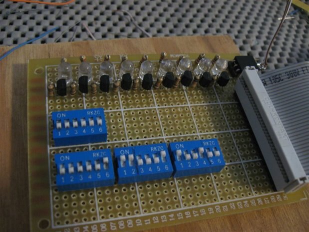

Here is the test-board (just light's and switches);

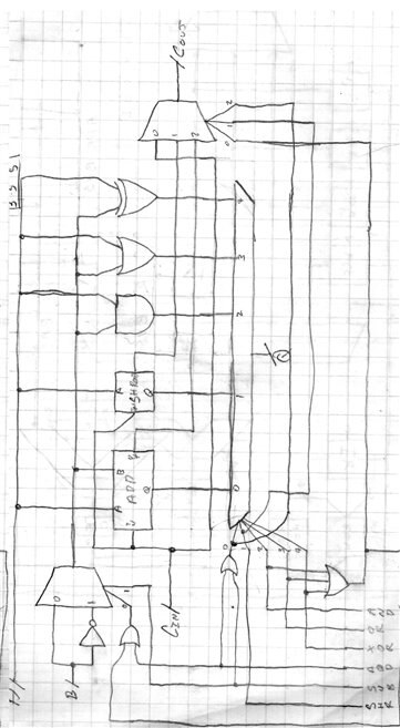

And finely the block diagram;

  • timswift
    timswift over 9 years ago in reply to clem57
    The six functions come from 6502 microprocessor the only difference is that on the
    6502 the inversion is done outside of the ALU.
    after the functions were determined I simply used a MUX to select the proper function and carry out.
    Another clever feature of the 6502 is addition and subtraction is always done with the carry in which is set beforehand (if desired).
    Tim
