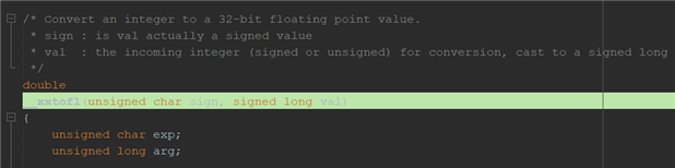

Bang! Found where! Taking a closer look I was curious about why this else if was jumping to function that converts an integer to float. Specifically, the problem was here:
    else if (integrator < MAXIMUM)
        integrator++;
    when I ran the debug, the code jumped into here:
    Then, I realized the definition of the macro MAXIMUM was a float (due to #define DEBOUNCE_TIME be a float)  which led the integrator to be converted to a float in order to perform that else if() :
#define DEBOUNCE_TIME 0.3
#define SAMPLE_FREQUENCY 10
#define MAXIMUM (DEBOUNCE_TIME * SAMPLE_FREQUENCY)
    And that took me some time to realize it because in my head it was so simple, 10 times 0.3 is 3 (and easy integer ). Casting the MAXIMUM to uint8_t would solve the problem, but I wanted to know how much this float in the ISR was costing me and therefore I wanted to measure it.
