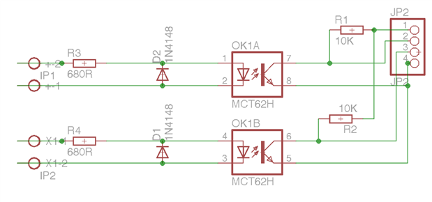

Thingatrons (blog post here) - the open collector driver boards that I (Lucy Rogers) made to control outputs from the GPIO pins on a Raspberry Pi - were great, but I realised I also needed to use various inputs to trigger the outputs.
And because I want my *things* to work out in the real world, and not just on my workbench, I use inputs that trigger on 12V, such as a motion detector or PIR.
If there's any kind of fault on the wiring or in the input, I could easily fry the Pi. Therefore I wanted to electrically isolate my inputs from the Pi. Fortunately there's a cunning way of doing this, using something called an optoisolator (also known as optocoupler or photo-coupler) . These are component that use a light emitting diode to trigger a light sensitive transistor. There's a nice article on optoisolators here.
Although I could make a one-off using some veroboard, I knew one would never be enough ... so I made a couple of PCB's ...
I again used Cadsoft's Eagle PCB Design Software - and again I was very grateful to the help given by James Macfarlane, who uses the software regularly.
Finding which parts to use and their corresponding items in the Eagle libraries was still the most difficult part. I used a dual-channel optoisolator (photo below), which means there are two LED's and two transistors inside the one component - therefore I could run two inputs through one PCB.
Here's the schematic:
Here's what I used, which Eagle library they were in and what they were called and their Farnell Part Number:

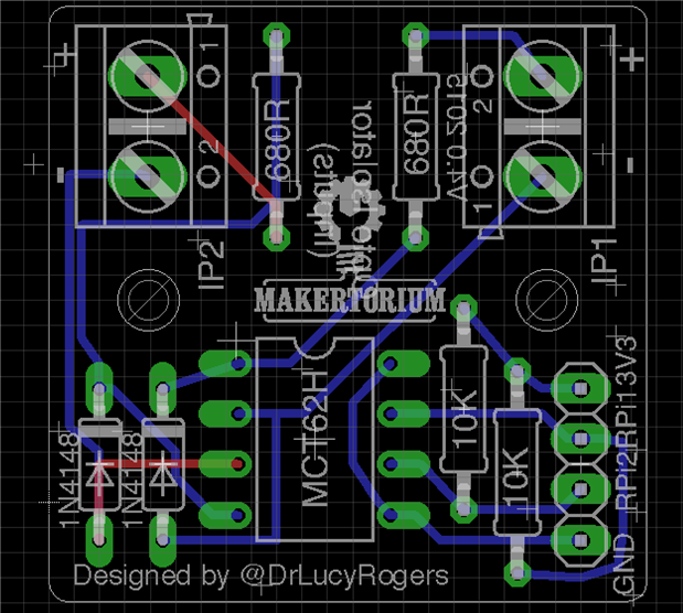

Once the schematic was drawn, I could move on to board. I spent ages re-arranging everything so I could use the smallest board possible (the PCB manufacturers charge by the size of board).
I was advised to route the board by hand since the autorouter is overkill for such a simple board. Also, the autorourter needs quite a lot of set-up in order for it not to do strange things.
Some other hints and tips included:
  • If you want to re-route a track you can use the "Rip-Up" icon. Double clicking a track rips-up the whole signal and returns it to the airwires, or yellow straight lines.
  • Use the "ERC" button to check the electrical connections
  • Use the "DRC" button to check if the design fits. This shows things like if the track is too close to the edge of the board.
  • Some tracks can be made thicker, particularly if they have a larger load on them. This can be done a few ways, but I find changing the "width" in "Properties" the simplest. (Use the "i" for info icon).
  • By "smashing" a component, you can separate the name or value from a part. This lets you move the name to a more convenient position.
  • Add mounting holes to the board, so you can secure it later.

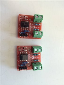

Here's the finished board in Eagle:

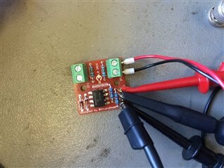

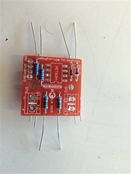

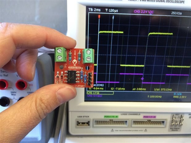

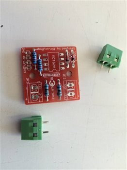

I then made the gerber files (search online for how to do this) and sent them off to Ragworm. I may have got a little bit over-excited when the boards arrived. I then added the components and ran some tests:

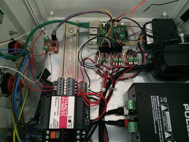

Once I was happy that everything worked, I used it in my first application - the Firecrackers - blog post and video here.
The photo below shows the optoisolator in the top left corner of the Firecrackers control box (the three other orange PCB's are the Thingatrons).

    Very nice design. I agree, setting up isolation between unknown sources and your device is a very smart idea and you have developed a very nice solution. Well done. DAB
  • derkarhu
    derkarhu over 11 years ago +1
    If you 'split' the input resistor into two components, and added a Zener diode between the mid-point of the resistors and the LED cathode, you would have an extended input voltage range, with a guaranteed…

    No pleasing some folk - beware the Arduino Forum. For first tries, not bad and I do know just how much work goes in, as well as a lot to learn. Electrons don't much care about angles, but you have plenty…
    Electrons don't much care about angles, but you have plenty of room to do the 45-degree thing as well as separations.
    Wider tracks are more robust and less likely to "lift". Double sided designs are better for established and tested boards, but things like via's can make minor component changes (desoldering) almost impossible.
    Press on
    In my opinion, PCB design is not good. I use Eagle for many years. It is great tool, but in beginning I had troubles with using it, because it has a little strange control for beginners. To be concrete, I didn't like these things on your design:
    1. Wires are too thin. If you can, use wider wires for bigger current. For your design you can use 32mils.
    2. Wire angles are not 45 and 90 degrees. it is a good practice to have wires with these angles. It looks better. You can check this option in DRC check.
    3. Some wires are too close. Yo can enable grid. I usually use 50 mils grid for simple PCBs like yours or 25 mils grid for complex SMD boards.
    4. Primary and secondary part are too close. It is a good idea to have bigger space between them to better isolation specially when some overvoltage peak goes there.
    5. Your design is double-sided which is needless. With some little changes like rotation of R4 and more space between wires around optocoupler you can have single-sided design, which can be reproduced also in amateur conditions, not only at professional PCB manufacturer.
  • drlucyrogers
    drlucyrogers over 11 years ago in reply to derkarhu
    Really nice idea -  although for this project I was going for the simplest option  image. Will consider it for the future - thanks.
