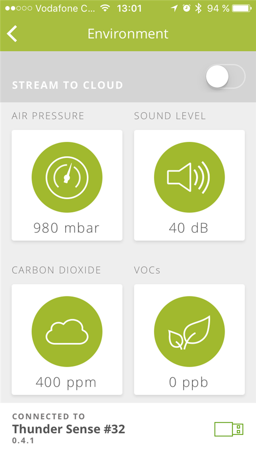

5. iOS mobile app screenshots
Last, I would like to add a few screenshots from the iOS Thunderboard application:
