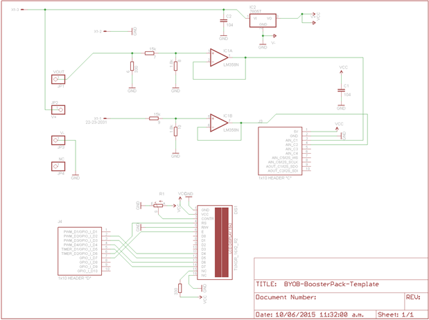

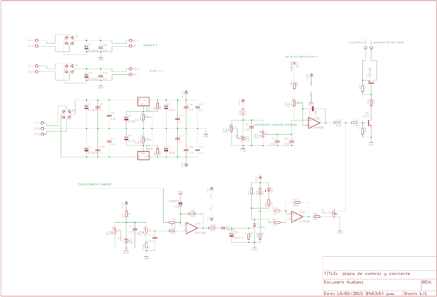

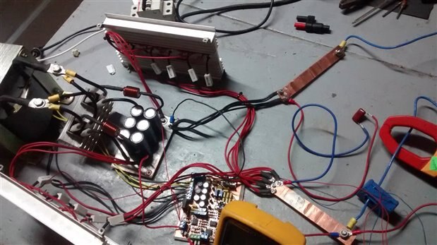

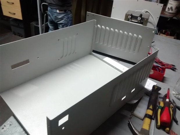

Developing a source for purposes of working with copper plates, which act as cathodes and performing leaching, so it requires high currents in DC, for this case a DC source having a current output maximum of 50 is requested amperes y 20 volts we had many problems to implement a protection circuit and display data on the LCD.
Schematic:
                                                                                                                                  Power Board
                                                                                                              Control Board

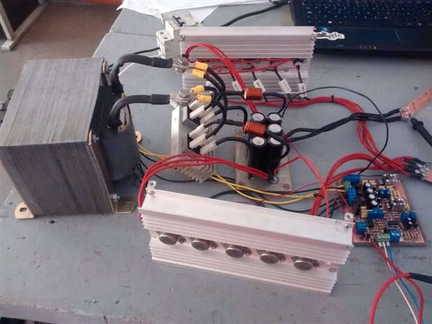

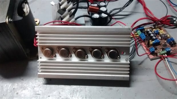

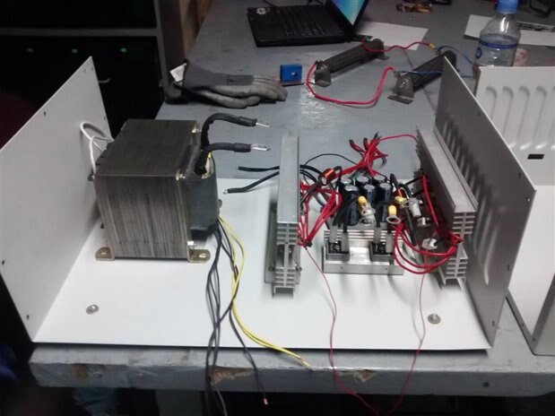

transformer and power transistors

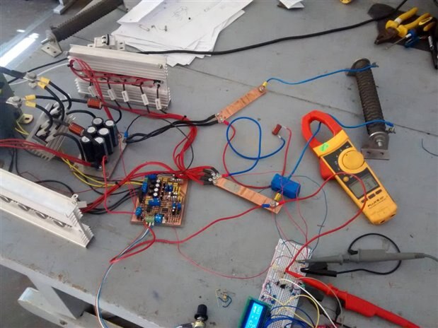

Test power resistors, each of 2 ohm

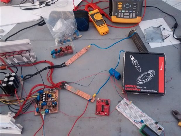

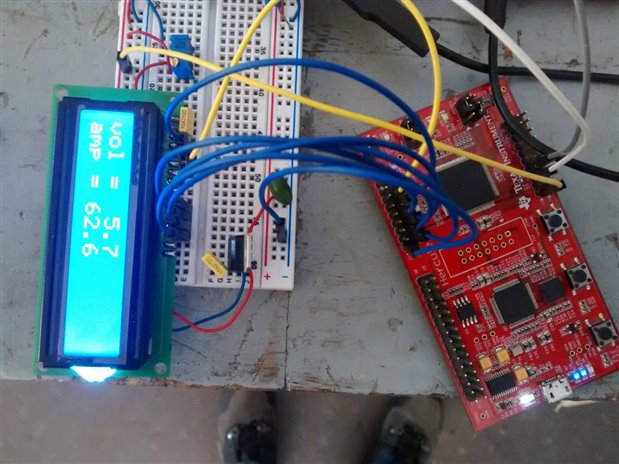

Fisrt Try (MSP430G)
A first attempt with the MSP430 Texas Instruments was performed to control LCD and displayar current measurement and votaje on screen, but we find the problem that it was necessary to calculate an RMS TRUE and microcontroller had no sufiente memory ,so I decided to use Hercules RM42x, with excellent memory and designed for Industrial applications.
MSP430G

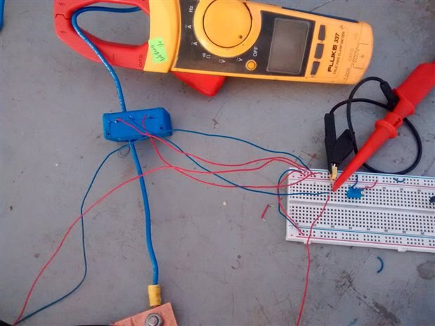

True RMS (Vol and Amp):
Somehow the current and voltage, given by the switching transistors was not linear as expected, making for a more accurate measurement is true RMS decided by applying a programming.
Hercules RM42x (100MHz/32bits)

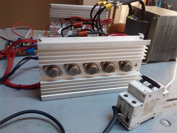

Control Power by transistor

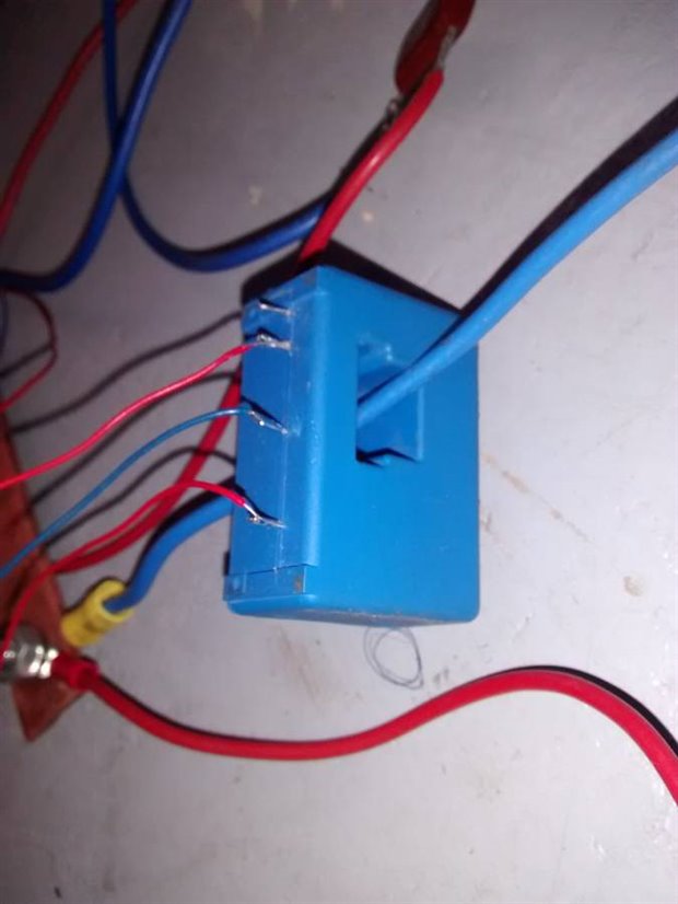

Current sensor (Current Transducer LA 125-P/SP4)
Last update here:
