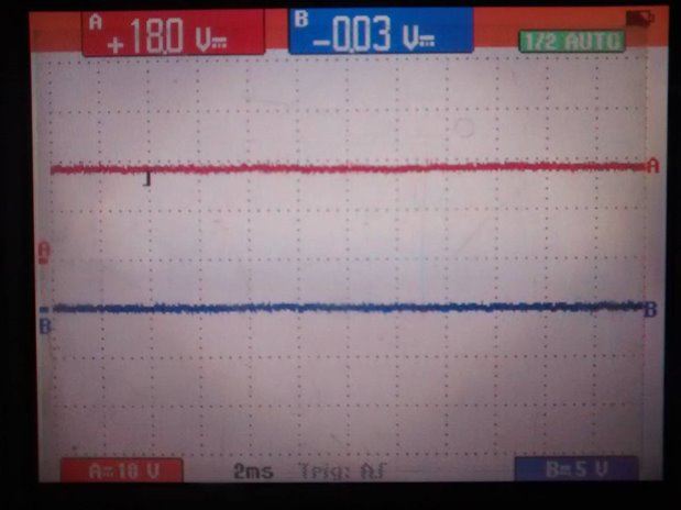

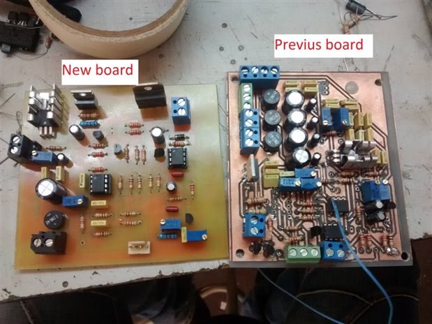

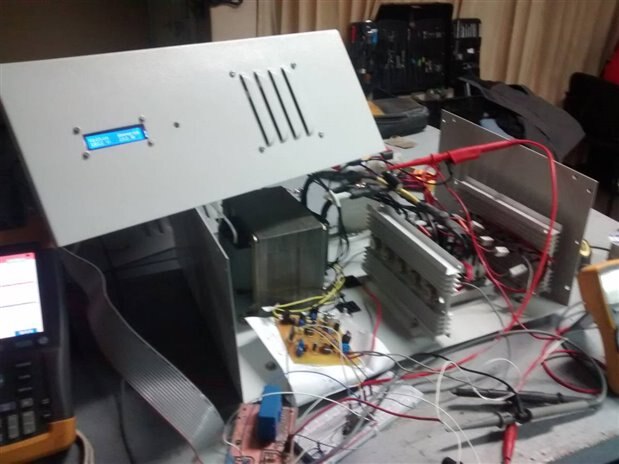

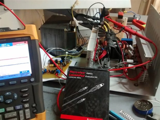

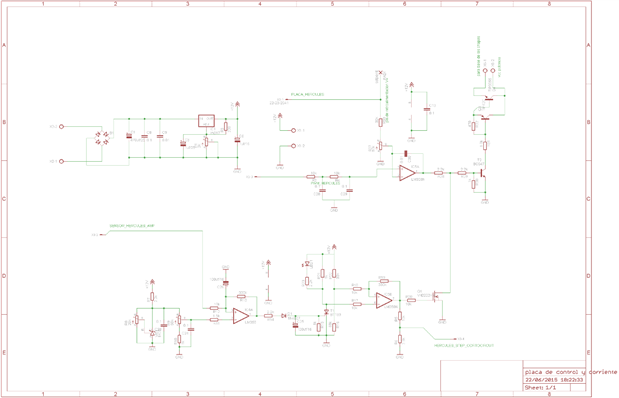

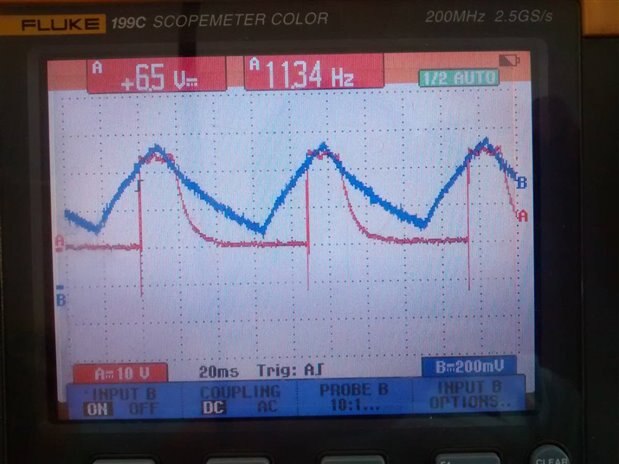

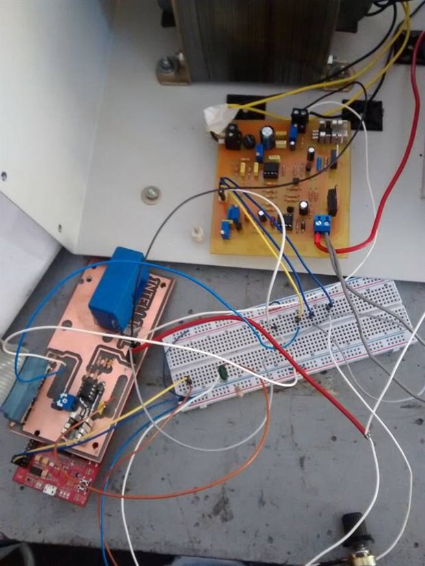

reasons for the upgrade:
The previous version only uses the Hercules RM42x platform as a device for displayar the voltage and current and the main board power supply uses dobre.

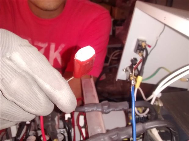

I have not understand the reasons but there comes a time when the transistors increase in temperature and begins to become sinusoidal current at a variable frequency.
Fails to find the reason of the problem, so I decided to improve the circuit and make some changes.
Giving much more functions to the Hercules RM42x platform as the main control device inside the power supply.
previous version error
This non-linear current is 10 Amps and do that the output capacitor overheating and damage to the capacitors.
Characteristics output capacitor:
1uF / 250 Volts / unpolarized

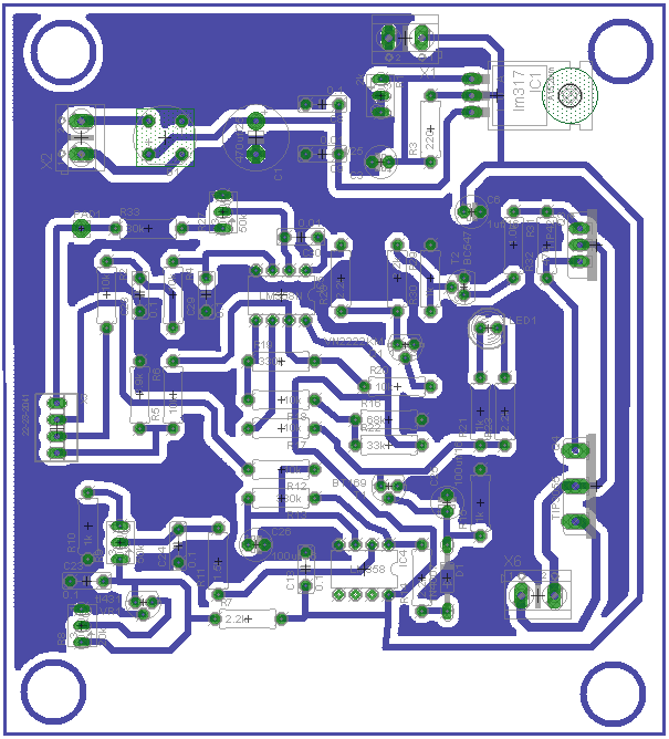

Upgrate:
Solution:
Output voltage signal red
Hercules RM42x
Previous Version

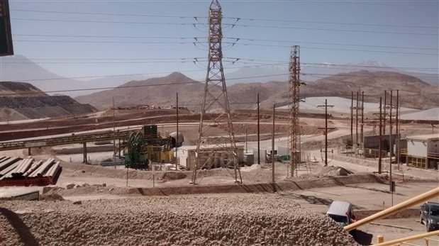

    Thanks for the tip, I guess the Monday, July 6 start to it use in laboratories.
    Laboratory leaching, "Cerro Verde / Peru-Arequipa"
