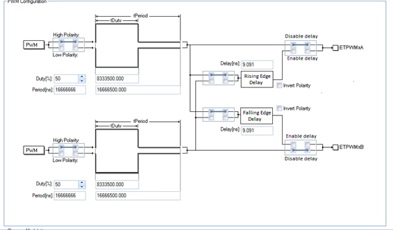

ETPWM Enhanced Pulse Width
The enhanced pulse width modulator (ePWM) peripheral is a key element in Modulator controlling many of the power electronic systems found in both commercial and industrial equipments. These systems include digital motor control, switch mode power supply control, uninterruptible power supplies (UPS), and other forms of power conversion. The ePWM peripheral performs a digital to analog (DAC) function, where the duty cycle is equivalent to a DAC analog value; it is sometimes referred to as a Power DAC.
As we can see in the image, you can see that ETPWM module uses two output pins of the microcontroller, side A and B, both outputs can be with the same polarity or one in reverse of the other.
The resolution of the module is of nanoseconds, generating a high resolution in the dutty cycle and in the dead band.

  /*Iniciando la carga de los valor de la banda muerta 1000---> 510 microsegundos*/
  etpwmSetDeadBandDelay(etpwmREG1, 1000, 1000);
  etpwmEnableDeadBand(etpwmREG1, pwm_deadband_config);
  etpwmSetDeadBandDelay(etpwmREG2, 1000, 1000);
  etpwmEnableDeadBand(etpwmREG2, pwm_deadband_config);

    That could likely be solved by configuring the deadband in the PWM module. I've done that for half-bridge, not for 3-phase though. There's a HET example that generates 3 phase signals from the timer module…
    There's a HET example that generates 3 phase signals from the timer module. That's complex though ...

    Jan Cumps over 9 years ago in reply to jc2048
    Jon Clift wrote:
    Does this Hercules board have enough PWMs for deadband control?
    It can be independently (or dependently) set for each of the 6 or 7 complementary PWM modules,
    Here's a signal that I created with one of these PWM pairs

    It is true that etpwm, is very powerful Hercules has enough modules to control a three-phase bridge, the example code I put above could help to control the triphasic.
    Once I get some GaN samples for high power, I will try to produce the three-phase signal in this way.
