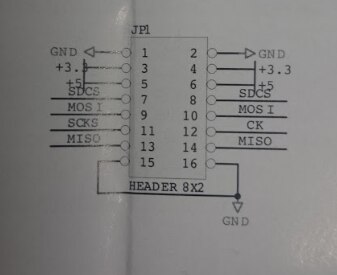

    i used this sd card holder
    SD Speicherkartenmodul - Bausätze / Module - Entwicklerboards - Sonstige Boards - Pollin Electronic
    and the pin out is
    Description                        MSP432                               SD card holder
    CS                                          P 5.0(J2-13)                        7
    MOSI                                    P 4.6(J2-15)                        9
    CLK                                        P 1.5(J1-7)                          11
    MISO                                    P 1.7(J2-14)                        13
    VDD                                      3.3                                         3
    GND                                      GND                                     1

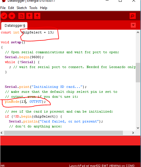

    I have changed the sketch file CS pin as 13 just like Martin has done ..
    when i run the datalogger sketch file I find the follow error

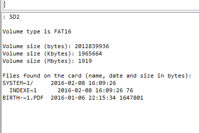

    when i run the cardinfo sketch file this is what i get
    can anyone help me out ???
