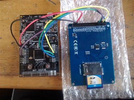

A few months ago my partner mohammedtowhidun, Start your project and one of the tasks that it should be was to control an SD memory card with the launchpad MSP432 of Texas Instruments, he after searching many blogs on the internet can found the great blog by shabaz, who implemented a Data Logger with TM4C123G Launchpad.
in this blog I present the operation of libraries for MSP432, with some changes.
Blog's Shabaz / Thank you very much for leading us to the answer
Tiva LaunchPad: Building an Event/Data Logger - Part 1 – SD Card capability
Tiva LaunchPad: Building an Event/Data Logger - Part 2 – Real Time Clock capability
interfacing sd card with msp432
MSP432 SD libraries Click to Download
Connection Diagram
Necessary changes in the program (Energia17)
Implementation
Important
it is necessary that the SD memory only has a FAT format as with other types of memory formats simplmente not work.

    shabaz over 10 years ago +3
    Hi Martin, Oh, that's awesome. Glad you managed to port it across with just a couple of changes! Very nice that the Energia code is so portable across the different platforms. I've had so little time recently…
    e14 Contributor over 10 years ago +3
    Hey Martin, hey shabaz In the first place, thank you so much for sharing this increadible useful information! I've been through many unsuccessful attempts interfacing a SD card with the MSP432 during the…

    Since this is a backlink from the 43oh forums posted by Martin V:
    http://forum.43oh.com/topic/9309-interfacing-sd-card-with-msp432-launchpad/page-1#entry71047
    there is a boosterPack available for SDCards. You may have to change the pinouts though based on the Launchpad you are using.
    For non Energia users, here is an MSP432 project with an SDCard:
    Full SD-Card FatFS Elm-Chan module support for the MSP432 Launchpad - Code vault - 43oh
