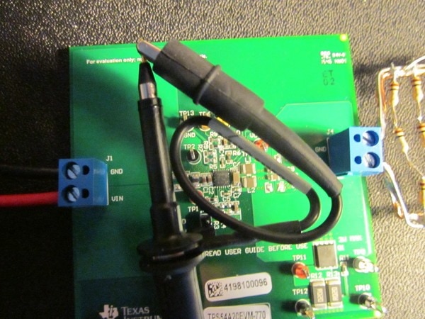

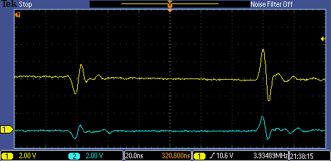

Here's what I pick up with an informal and rather crude near-field probe (it consists of loop made from
the flying earth lead shorted to the probe tip)
It doesn't tell us anything about the levels (no calibration and you can't simply extrapolate from a
near-field measurement of the magnetic field to what happens further out anyway) but it does show that
there is something there. Shame I haven't saved up enough money for a spectrum analyser yet.

    The important thing here is to keep the noise away from anything that's of a dimension that it can act as a aerial. A quarter wave at 175Mhz is a bit under half a metre. A tenth of that will still radiate, though obviously not as well as the quarter-wave, and that's only 5 or 6 cm. If the board layout is good (and it had better be, with a 10A converter switching at 2MHz), you won't have current loops of that scale, so most of the worry is radiation off of longer traces and wiring, particularly the power distribution to the board. If you have a tin can it only works if you filter everything going in and out, otherwise the emissions just run out via the connections. In this case the filtering might be enough as long as it's close in to the converter. Either that or investigate ways to reduce the noise in the first place, which is usually better if you can do it - though here it may be inherent in the topology with the capcitor and the inductors (designing out emissions is normally better than trying to contain them).
