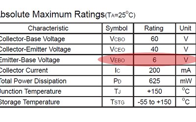

On a datasheet the maximum figure for this junction is often given as 5V or 6V (for the kind of silicon, small-signal,
bipolar junction transistor that I'm using in my experiments).

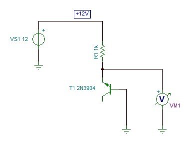

Obviously, the manufacturer gives themselves some leeway, so the actual breakdown voltage is going to be several volts
greater than that. Unlike the case of the collector-emitter breakdown blog, where I used a switching circuit with an
inductor, here I'm just going to treat the junction as though it were a zener diode and put a resistor in series to
limit the current. These test circuits are getting simpler and simpler.
Here's the circuit:
The simulation just reported that the voltage at the transistor-resistor node was 12V, so it doesn't model the
breakdown (at least, not for the 2N3904 part that I selected from the library).

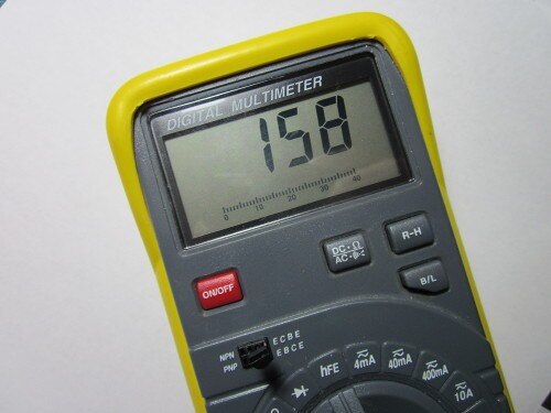

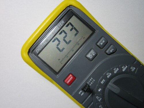

Before I try it, I'm going to do something that won't necessarily make much sense now, but you'll understand why I've
done it a bit further down; I'm going to measure the beta of the part [I haven't done beta yet - talk about
unstructured blogging - but it's the DC current gain of the transistor, the ratio of collector current to base current
measured at a particular collector current, and on a datasheet it's often referred to as hFE - I haven't done hybrid
models either yet, but if I keep throwing in these little morsels it'll all seem quite natural and familiar when I
eventually do]. Here is what my cheap meter with a transistor test facility says for the gain:

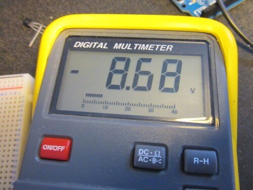

Here are the results of the reverse breakdown:

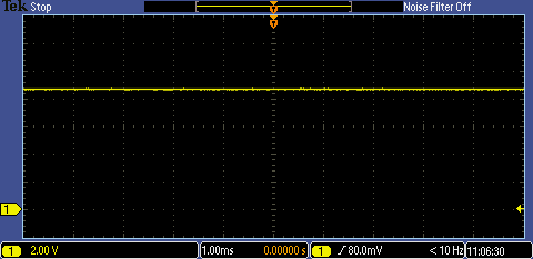

and here's what it looks like on an oscilloscope:
So I've got myself an 8.7V zener.
Now I've had the transistor running like that for 10 minutes, I'm going to take it out of circuit and measure the beta
again. What we can see is that the breakdown has done some damage to the device and affected the gain.
I have read in books that there's a certain amount of recovery of the gain afterwards, but I'm not seeing that with
this device; several hours later it is still reading 158.

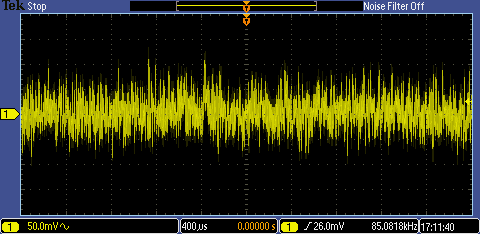

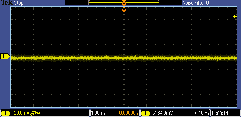

Here's the noise, as seen by my scope. Unfortunately, that's the best the scope can do.

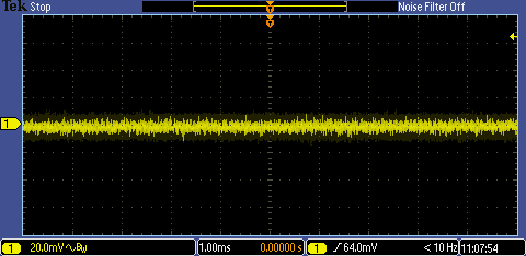

Before you go away with the idea that all of that comes from the emitter-base breakdown, here's what the scope shows
when the input is set to ground.
