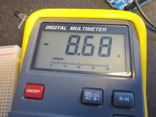

Here are the results of the reverse breakdown:
and here's what it looks like on an oscilloscope:
So I've got myself an 8.7V zener.
Now I've had the transistor running like that for 10 minutes, I'm going to take it out of circuit and measure the beta
again. What we can see is that the breakdown has done some damage to the device and affected the gain.
I have read in books that there's a certain amount of recovery of the gain afterwards, but I'm not seeing that with
this device; several hours later it is still reading 158.
