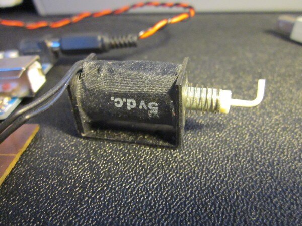

I'm going to repurpose the board I used for the switching experiments. This time the load will be a small solenoid I found in a box of
old bits. It measures 53.16mH, 54.4ohms with the plunger partly out and 62.66mH, 54.3ohms with the plunger in. The inductance varies
because the plunger forms part of the magnetic circuit. It says "5V d.c." on the side, but I'm going to run it on 8V - with a
resistance of 54 ohms that will be a current of 150mA which the 2N3904 can manage. It's only going to be energised for short periods

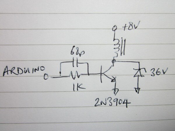

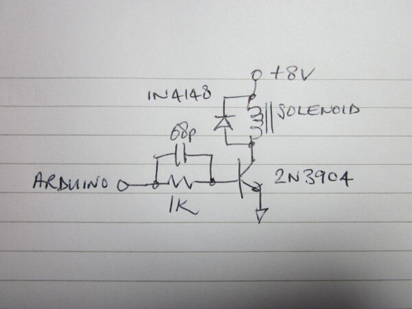

Here's the circuit.
You can see I'm starting with a 1N4148 signal diode to provide the protection for the transistor. The part can handle the initial
150mA easily and it's fast, it can switch in under 4nS, so it won't have any problems catching the coil voltage as it goes up.

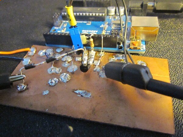

Here's the board (another example of my award-winning photography - I won't tell you what the award was or where it came from).
[Just realised that this shows the board from later on when I'd swapped to three zeners. Never mind.]

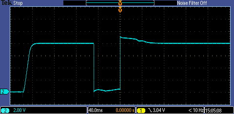

This time it's simulating a monostable. It waits a while, takes the input high, waits a while, takes the input low and then sits there
and twiddles its thumbs. The scope is set to trigger on the falling edge so I can see what happens when the transistor turns off,
interrupting the current flowing, leaving the poor solenoid with a whole load of energy in its magnetic field that it has to dispose
of. Here's a trace showing the collector waveform - the trigger is coming from the input wavform on the other channel which isn't
being displayed. This trace is slightly embarrassing because you'll notice that just before the trigger point, where the transistor is
on, the transistor isn't quite bottoming. Basically, I don't have enough base current and that's because the DC current gain (beta or
hFE on a datasheet) falls considerably at higher collector currents but, without thinking, I've just chosen the kind of base resistor
you'd use at a collector current of 10mA where you know the gain will be at least a hundred. I'm just going to leave it because it
doesn't make any real difference to what I'm doing.

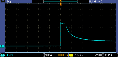

Now for a slight change. This time, instead of the diode across the coil, I've used a zener diode to catch it.
I've actually used three 12V zeners in series [since that was what I had to hand], which will clamp at about 36V. It could have been one 12V
zener; this is for illustration so we can see the way the coil lifts the voltage and how fast it is but without the transistor
breaking down (Vceo max is 40V). This time the energy is being directed to ground, which might be an advantage if you were switching
several solenoids simultaneously and didn't want all that disturbance to the positive rail (as long as your ground was nice and solid,
of course).

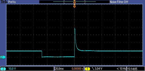

Here in a bit more detail
I don't think that the tail afterwards is energy from the coil, I would imagine that it's the zener and transistor capacitance
gently discharging from the 36V.
The zeners clamp nice and cleanly (the coil is only trying to keep the 150mA going, so they're not hit in the way a TVS diode
would be trying to clamp a large transient).

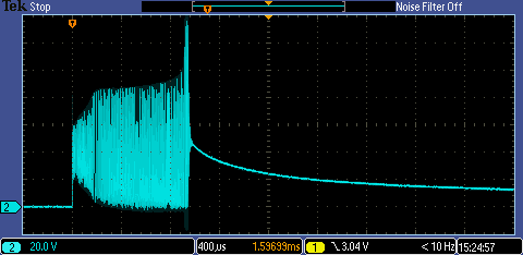

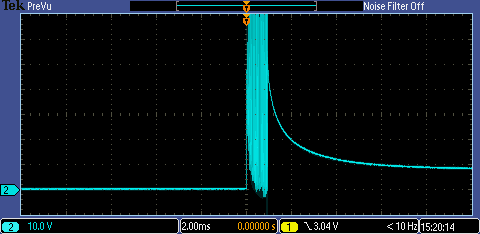

Now, finally, I'm going to throw caution to the wind, remove the protection components and let the transistor have a go.
This was my first go. I haven't got the scales right, not knowing what to expect, but it does show that the situation is messier than
with the zeners even though the collector breakdown is, in theory, an avalanche effect and I would have expected it to look something
like the zener case.

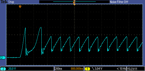

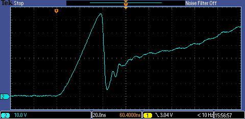

Above is the start in more detail [initial breakdown is around 80V] - and what's evident is that I've created an oscillator. I suppose it's a 'relaxation oscillator' in
form. The transistor avalanches, the voltage comes down, the coil ramps it up again, and it repeats. It's running at about 5MHz.
Essentially, the avalanche gives us a negative resistance which can support oscillation. That was unexpected, but really neat.
Here it is on a longer scale (the raggedness is aliasing of the scopes sampling). After about a millisecond the coil's energy is dissipated and it
finishes. Amazingly, the transistor survives all this abuse. I'm pretty sure it would fail if I made it repetitive, though.
