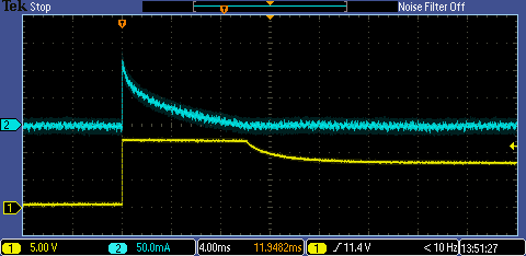

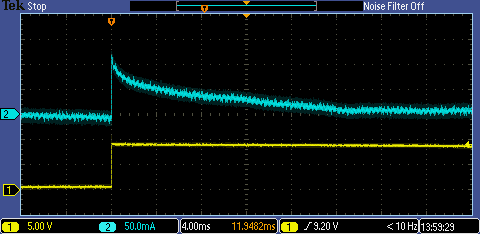

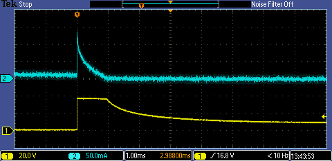

    From first principles, we can say that the initial current through the protection device is simply the coil current
    (that's what the coil is trying to do - maintain the current that's flowing). The current will then decay, because
    it's being powered by the energy in the coil's magnetic field, and the energy will gradually deplete because of the
    dissipation of the protection device. In the case of the signal diode, that dissipation is quite low - the initial
    dissipation is only 600mV x 100mA = 60mW and it falls as the current falls [the voltage doesn't change all that much because
    of the diode characteristic]. In the case where I had three 12V zeners in series, giving a composite zener of 36V,
    the dissipation is much higher at the start so we'd expect the current to drop much more rapidly.
    I tried it. Here are the traces.
    This is effectively a 36V zener to ground (3 x 12V zeners in series):
    This is a single 12V zener to ground:
    This is a 1N4148 signal diode, across the coil:
    Note that the first one is 1ms/div horizontal, the others are 4ms/div.
    So, yes, if you're worried about the rate of decay of the current through the coil, a simple diode might not be the
    way to do it.
