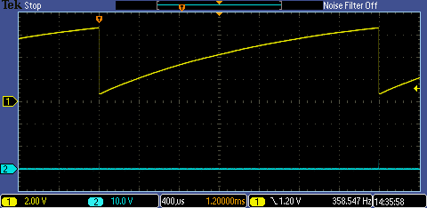

If we connect the device to an RC circuit, the capacitor will charge to the trigger voltage, discharge until there's no
longer enough current to keep the device active, and repeat the cycle. [In practice, it's slightly more complicated than
that, because the dynamic load-line doesn't meekly follow the curve down, rather the capacitor holds the voltage up and the
dynamic load-line swings out and back again.]
Practical Experiment
So let's try that on a breadboard.
Here's the circuit and the constructed circuit:
This is the voltage across the capacitor (yellow trace). The frequency is approximately 360Hz:
Here's the voltage across the 47R (blue trace) when it's discharging the capacitor:
