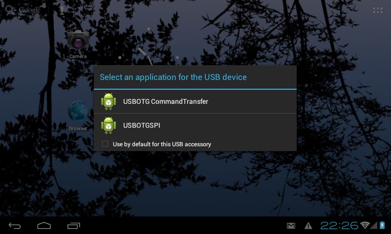

The APP
The app is created using Android Studio. Minimum requierements are a hardware that support usb otg and software minimum icecream sandwitch 4.0.3.
Android ask for launching the app as soon as the CP2130 is connected to the android device, and detected (recognized by VID and PID).

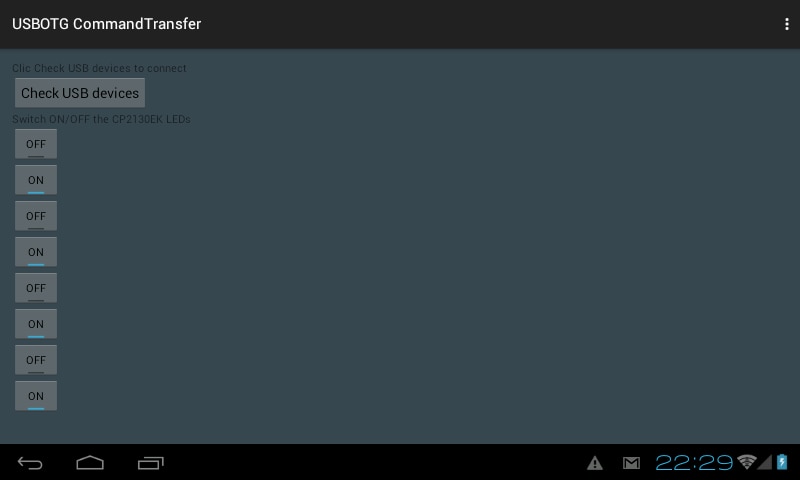

Once launched, when click the button “Check USB devices”, the app gets a list of the attached and search if the CP2130 is in this list, if so, connects to it.
There are 8 toggle buttons that are used to switch on and off the LEDs connected to the gpio's of the cp2130, to do this we use the commandtranfer functions incuded in the Android APIs see pictures taken from an 7 inch tablet (over ADB connection) and a video of the app running on a mobile phone.
