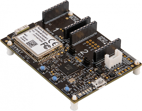

This blog uses the Azure sphere MT3620 Starter KitAzure sphere MT3620 Starter Kit to implement support for a several MikroE Click boards.  There are actually over 650+ mikroBUS(tm) boards (referred to as click-boards) with all types of sensors (see https://www.mikroe.com/click for a complete list).  For the demonstration programs discussed in this blog, support is limited to the boards listed in the Sensor Evaluation using MikroE Click Boards blog.
Overview
The MT3620 Starter Kit was chosen because it supports two MikroE click-board sockets as well as several on-board sensors.  With the variety of possible sensors, the goal was to demonstrate the different I/O interfaces using standard library of ANSI C library functions.  The library I am using supports the following click-boards:
  1. BAROMETER ClickBAROMETER Click -- uses the I2C interface for interactions
  2. FLAME ClickFLAME Click -- uses Binary I/O for interrupt input and ADC inputs
  3. LIGHTRANGER ClickLIGHTRANGER Click -- uses the I2C interface.
  4. OLED-B Click OLED-B Click -- uses the SPI and Binary I/O interfaces.
  5. RELAY ClickRELAY Click -- uses Binary I/O interfaces
  6. TEMP&HUM ClickTEMP&HUM Click -- uses the I2C interface
  7. LCD MINI ClickLCD MINI Click -- uses a combination of SPI and Binary I/O interfaces
Some click-boards, like the relay-click,  are simple Binary I/O while others, like the LCD Mini click, involve multiple SPI bus and Binary I/O interactions. In the demonstration program discussions, any unique interface attributes will be highlighted.

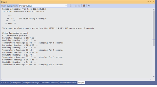

The 'click_demo' project can exercise three of the click boards--the Barometer Click, Temp&Hum Click, and OLED-B Click.
Barometer and Temp&Hum click board
Default operation is to utilize the Barometer and Temp&Hum clicks.  You can install these two click-boards in any order you desire because the attached boards are queried to determine who is present on the board.   When the demonstration program starts, it queries for each potential click-board and if the response is correct, that board is signaled as present and utilized with output being routed to the Visual Studio output window.

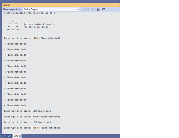

flame_demo program
The software for this demonstration program assumed the Flame Click board is inserted into Slot #1.  The click board only requires access to the AN (analog) and INT (interrupt) pins but I used slot #1 when developing it.  Additionally, though the Sphere SDK will eventually support the ADC, when this software was developed, it didn't so the functionality for reading the ADC hasn't been incorporated into the demo program.
When the program is compiled and run, it will monitor the INT pin for flame/fire detection and display a message when it is or isn't seen.  You can force the transition by varying the potentiometer that is on the Flame Click board.  When the demo is run, its output is:

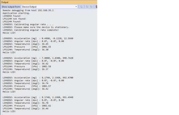

lcdmini_demo
This demo uses the LCD mini click to continuously output values read from the LSM6DSO that is on-board the Sphere board every second.  It is required to be inserted into Slot #2 for proper operation.
In addition to the data output on the LCD mini display, it is also printed to the output window:

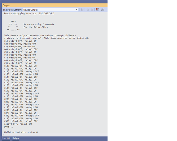

relay_demo
The Relay click board cycles the two on-board relays through a series of combinations on/off states. Essentially, it counts from 0 to 3 using the Relay LED's to indicate which relay is active and which is not.  For this demo program to operate correctly, the Relay-Click needs to be placed in Slot #2.  When compiled and run, the following output is provided:
As the program is run, you will see and hear the relays open/close and the LED indicating the relay state will either illuminate or go-dark.

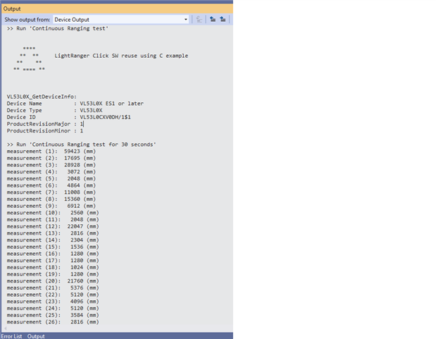

tof_demo
The TOF (time of flight) demo uses the LightRanger 2 click-board.  This click incorporates an ST VL53L0X Time-of-Flight laser-ranging module.  The code for driving this sensor is originally provided by ST Microelectronics and was adapted.  This board uses the I2C interface for communications so it can be placed in either Starter Kit mikroBUS socket.
There are a number of different tests that can be run:
  1. Continuous Ranging
  2. Single Ranging
  3. High Accuracy
  4. High Speed
  5. Long Range
The desired test to be run is specified by editing the app_manifest.json file and placing a -1, -2, -3, -4, or -5 in the "CmdArgs" field.  You can also modify the duration of the test (it has a default time of 30 seconds). Once the test begins running, its output is similar to:
The Device Information is read from the VL53L0X device during startup and once the testing begins, the data is displayed to the user and the total duration of the run is displayed.
