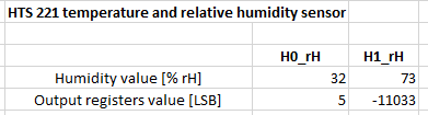

I will consider the STMicroelectronics  HTS221HTS221 as an example. The sensor outputs temperature and humidity in 16-bit registers in 2nd complement format I will now focus only on relative humidity measurement (the temperature is the same. The datasheet states that the output should be linear (related to the humidity) and two reference values are provided (stored in the sensor by STM) - two output registers values at obviously two relative humidity values at which the registers values have been recorded.

So I have read the calibration values over I2C and entered them into an Excel spreadsheet:
Here comes the first surprise, but let's visualize it. I selected the data and notes (B6:D7) and inserted a scatter plot:

This is another way to compute the sensor output value than using the computation from the application note. (Try it yourself with an calculator.) This makes no sense in this case, of course, since the equation suggested by STM satisfies with integer values. The power of computing and showing the trend line and the R-squared value is in all unknown characteristics. (For example if more values are measured and you are not sure, whether the sensor provides a linear / logarithmic output.) The R-squared value here is 1, which would normally mean a perfect match of the suggested function to the values provided, but we got that because we provided only 2 values. The more values, the better idea of the relation you get.
