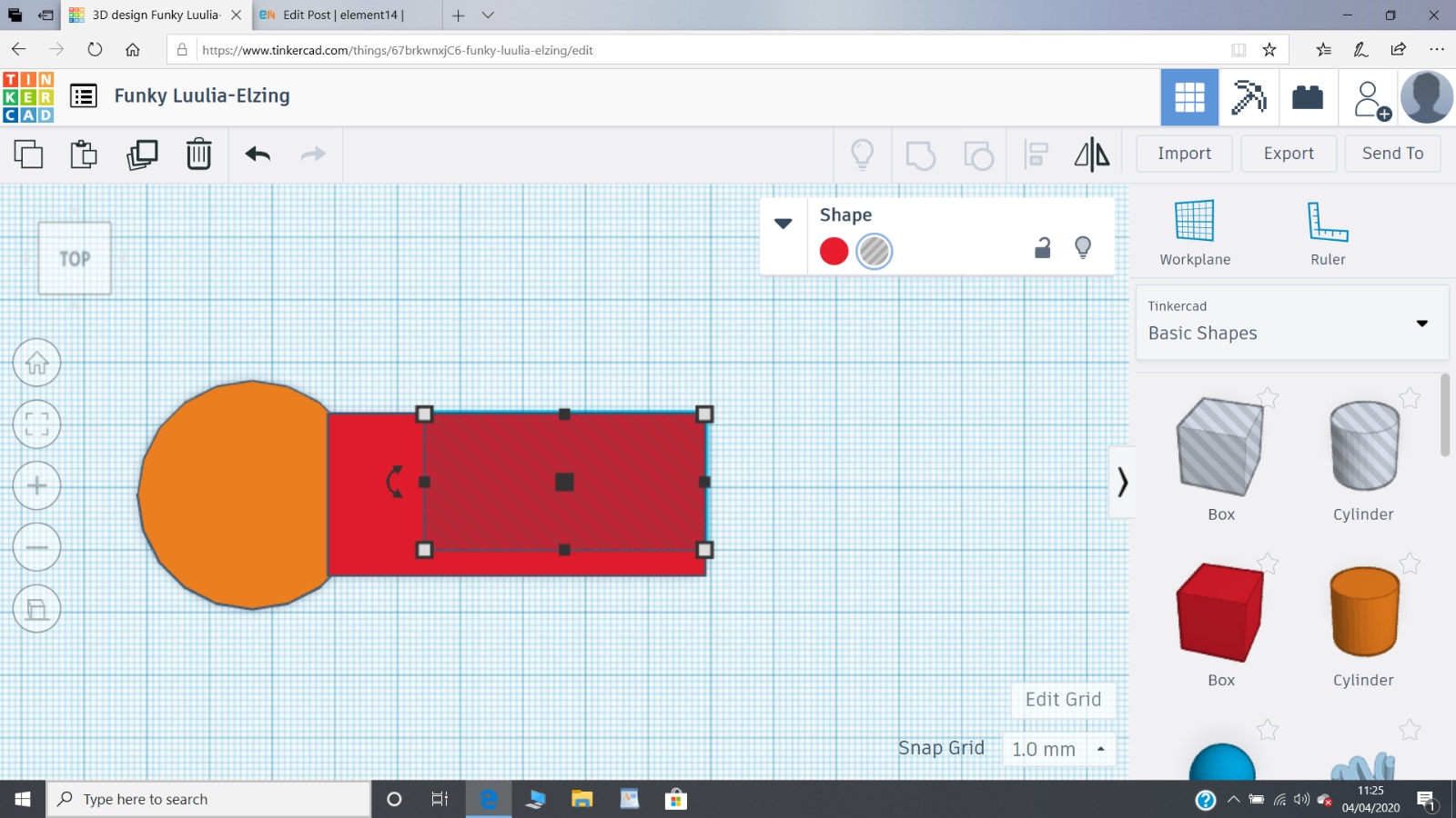

I am starting with a cylinder of diameter 36.4 mm. This is because the battery holder has a diameter of 32.4 mm and I want to have 2 mm thick walls. The battery holder is 12.8 mm high so the height of the case needs to be that, plus the case thickness (2mm), plus the space for the top piece (1.5 mm - why not), making a total height of 16.3 mm.
Next I will add an oblong which will hold the Nano Sense. The Nano Sense is 21.7 mm wide and 44.7 mm long so an oblong 25.7 mm wide (2 mm sides) and 60 mm long (allows a bit of leeway on the positioning of the Nano) seems about right. This will overlap with the cylinder. A close up view enables me to see that I have just enough overlap.
Before I 'join' these two parts together to make a single part I will just check the Nano Sense will still fit inside by making a 'hole' the size of the Nano and fitting it inside. I do this by adding a hole of the correct size (21.7 x 44.7) and positioning it to align perfectly with a top edge and end edge, see below, then I remove this 'hole'  as it is no longer needed.
Then I can easily move it down 2 mm and left 2 mm so that it will be perfectly positioned and that has worked nicely.
