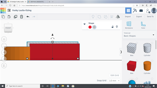

I know need to design the lid to fit onto the top of this bottom case. This is actually relatively easy. I want the lid to be an exact fit into the case so all I need to do is to make a duplicate of the Bottom part in TinkerCAD which I have named as NanoSenseTop and uncombine the various parts, as illustrated in the side view below.
Then I just convert the two hole parts into solid part and make their height 3.00 mm, as shown below.
The previous 'holes' then become the solid that will exactly fit inside the bottom case and make a perfect snug fit. Well, that's the theory, let's see how the 3D print turns out.
Now to 3D print it (it will take 49 minutes) and see how good it is. Looks like time for more tea and sunshine.
Well, I've been in the sun and planted my early potatoes (actually they're a bit late now) and the Nano Sense Top has printed and been cleaned up. It fits perfectly, apart from the problem with the wires from the battery holder but with a bit of carving and sanding it should be possible to perfect that imperfection as well.
