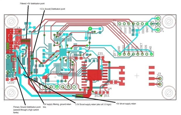

    genebren over 7 years ago in reply to Andrew J
    Andrew,
    I have long since left ground flooding behind due to the possibilities of coupling high frequency noise into the ground plane.  I now purposefully route my power and ground in a true star pattern, with the center points located as close as possible to the output source.  I learned this lesson the hard way.  There are plenty of good resources out there on the web.  (I used to have a very good collection of application nodes from Analog Devices in book form that I received at a conference presentation, but I can't seem to lay my hands on it right now, hopefully still packed away).
    Here is an example of the star point distribution of power and ground (this is a fairly high power board):
    In looking more closely at your layout, there are a couple of things that I would do a little differently having to do with component placement and routing:
    1) You have ground flooding directly below the main switching line of your LTC1624 - SW output, including the inductor.  This creates a high degree of coupling of this high frequency/current line to ground. (Of course I would avoid the flooding completely)
    2) The component placement between the LTC1624 and the two LT3081s is quite long (flooded below and to the sides to ground).  I would move the LT3081 as close as possible to the LTC1624 and orient the parts so they have near equal distance to the output of the LTC1624.

    shabaz over 7 years ago in reply to Andrew J
    Hi Andrew,
    You're right, that top-left quadrant of the board (i.e. power entry) should have its ground plane linked directly to the switching regulator portion below, because currently there's a long path for any input capacitance for the switching regulator. That's an easy fix, by scraping off some solder resist and patching it with wire.
    Regarding Rsense, this is for limiting current - I think you're ok with the low resistance you have; a higher value may accidentally cause the chip to think the output is being overloaded.
    The step-down converter tracking is a nice idea, but definitely complicated : ) Anyway I just wanted to say, I hope you stick with it, because you're close to getting a good design, and large chunks are functioning. This first PCB is really still part of the design iteration, and the place to measure/experiment as you're already doing.
    In terms of PCB layout, it's a lot better than some. Generally it's good. Once you've decided on the areas that need separate planes, it gets hard to follow them if there are too many traces on it, so it's good to make the underside have almost zero traces, or very short length traces, to reduce the risk of breaking the plane too much. The top plane then just becomes an accoutrement, and not necessary, apart from providing some copper fill. Due to the complexity, your design does have lots of broken ground plane on the right side, but sometimes it can't be helped.
    Also, it's great that your design has many interesting features like the on-board diagnostics from the thermistors, and the nice user interface. It's always cool to try new things : ) When experimenting with PSU ideas, I liked the idea of an electronic fuse, or other similar algorithms.. I would find that more useful than traditional current limiting, but maybe I'm unconventional : (

    Andrew J over 7 years ago in reply to shabaz
    Thanks Gene/Shabaz.
    I’m not giving up yet because it’s my first project and I’ve got ideas for v2.0 which I want to have a go at!
    I want to check my thinking re: balance of the linear regulators, bodge the ground plane link between switching regulator and power input and get to grips with how the feedback circuit is actually working.  I also want to see how it operates with an active load and look more into grounding principles.  Then I’ll determine how to proceed.  Current thoughts are to do at least, but subject to above:
    • change grounding to keep the power/switching/regulator,control sections separate;
    • reposition the linear regulators to ensure equal distribution of switching output.  I did do the trace measurements but as Gene says, it’s still a long track;
    • move the output terminal away from the sense and control terminals
    • add some test points on to the board
    • make any adjustments to the feedback circuit that are needed.
    Hi Andrew,
    For the switching regulator (step-down converter), the input capacitors are very distant:
    Although the positive terminal of the capacitors (C1 and C2) are close, the negative terminal has to take the yellow route, which looks >50mm if I try to measure the line. The solution (on your current PCB) is to either add another capacitor closer across pins 8 and 4 (Vin and Gnd), or scrape some solder resist off and provide a wire bridge across the shortest distance between the two plane regions.
    I don't know if it is having a noticeable impact, but it would be good to eliminate it, because this distance is about 5 times more than what is achievable (it is possible to have a capacitor within millimetres of the pin) for a path that will have high frequency high current flowing.
