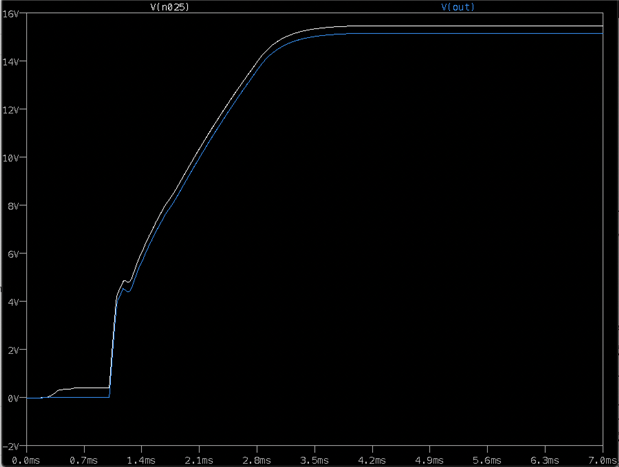

LTSpice simulation rise time:
The actual rise time to the set voltage is 12.7ms actual vs 2.1ms simulated.  There are similarities in the waveform but it's not clear why the rise time is so slow - my suspicion falls on the MOSFET, see Conclusions.

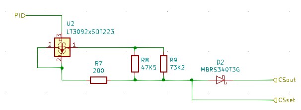

  • Andrew J
    Andrew J over 7 years ago in reply to shabaz
    It's part of the current control stage:
    When I created the design in Kicad I split it up into separate sheets so it was possible to break into the subsystems (if that expression is used with electronics!) - makes it a bit more difficult to follow image by image, so I will attach a PDF of the whole design to this blog posting.
    Here's the modelled output from LTSpice ( Vn025 is the SET pin voltage) - not as ideal as doing the measurement on the PCB but I'm still fixing it!
