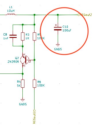

As I noted at the start, I decided to document the testing progress so far as there are clearly issues and I guess part of this whole project was to document how it came together, good and bad!  The 5 Ohm load results I’m not sure what to make of or how to proceed - it clearly doesn’t like such a low resistive load but I don’t have any other way I can think of of testing it.  I can’t understand what is up with the current control connection either - why would touching it with such a low load affect the voltage?
I’m wondering if the Mosfet is causing some of the issues.  In this thread, Jon Clift points out it may well cause problems and it is definitely out of conformance to the requirement of the LTC1624 which requires a maximum 2000pF of input capacitance on the connected Mosfet (the one I have is 3247pF so way over.)  I’ve hunted down another one, IRL8721PBF, but it’s not easy!  There are 10s of thousands of the things and the parameteric search on Farnell/CPC is hopeless for purpose.  I’m also not sure what the important specs to look for are but I have read around and here’s a comparison of what I think the important ones are:
The rise/fall/delay times seem to be heavily dependent upon the specific circuit they were tested with but I quote them for comparison purposes.  The Total Gate Charge seems to be a better indicator of switching time and the IRL is significantly better.  The input capacitance is well within requirements as well.
My approach now is to:
  • replace the MOSFET with the IRLB8721.
  • replace the power switch with an filtered module as per Michael Kellett’s suggestion in this thread.
  • bodge in a 0.4mH Common Mode Choke between the Power stage output and Control Stage input.
  • test voltages at various points of the circuit to compare with what the LTSpice simulation is reporting.  It may give me a clue as to where issues lie - perhaps I’ve mis-soldered a resistor or capacitor (shame these can’t be tested in-circuit.)
Why a filtered power module and Choke?  The frequency I was seeing the noise at seems to range from 60kHz to 130kHz and the datasheet indicates this would attenuate; I’m wondering if some noise is coming in through the power lead; I’m also wondering if this thing switching is potentially introducing noise on other equipment which I need to deal with.  I may have grasped the wrong end of the stick here completely though
If anyone has any other suggestions then I’m really open to hearing about them.  I’ve come a long way and I feel so close - It’s a bit disheartening if I’m honest: it all seemed to be going so well!

  • jc2048
    jc2048 over 7 years ago +4
    Hello Andrew, Having now looked at your schematic and their design article [I'm doing this all backwards!], here are a few quick observations. In the context of their circuit (I found your schematic confusing…
  • Andrew J
    Andrew J over 7 years ago in reply to genebren
    I realised it was fine after posting it - I've been at this all day so was clutching at straws when I first saw it!  This is the top of the board; the bottom of the board is the ground plane and there is continuity across it so all is good - this is the bottom layer flood (silk screen still shown):
    I was just starting to look at trying to bodge in a capacitor - I've been checking the voltages and what is coming out of the inductor is as simulated in LTSpice.  It's the switching noise that's killing me - I was going to try and solder something in between Pin 2 of the inductor and the ground of C10.  I think perhaps I should leave it for the day now as my brain is clearly addled.
    genebren over 7 years ago in reply to Andrew J
    Andrew,
    In a perfect world, I might have made the REGin trace move from the inductor (L1) to the capacitor (C10) and then off to the regulators (and maybe even moved C10 to be a bit closer to L1).  But this is a very minor point.  Given the trace widths and the shortness of the traces, I see little wrong with the routing.  I am a little confused, but is this image prior to the flooding of the ground plane (GNDS2)?  I don't see any of the actual flooding, with the GNDS2 pads seeming to be unconnected.  Like I say, it could easily be my misunderstanding of the view that you have shared.
    I also make it a practice to use a low value capacitor (0.1uF or so) in parallel with my high value capacitors (100uF) to assist in suppressing higher frequency components of the noise.
    Gene
  • Andrew J
    Can someone confirm that I've made a rookie mistake putting my PCB together:
    Note the path from the inductor, through the electrolytic capacitor, off to the linear regulators (REGout2) in the schematic.  Note the paths in the PCB - REGin disappearing off the right side is off to the linear regulators.
  • Andrew J
    Thanks for the encouragement, I’m not giving up yet - too many ideas for improvements that I want to make in v2!
    The MOSFET I’ve used is definitely suspect and I’m looking at ways of providing a direct DC input from something like a wall wart to see if excessive power stage ripple might be an issue, something I considered after posting.  I have something that can provide up to 1A at 9v (and about .7A at 12V) but I’ve not tested its quality.
    please do take a look, I’d appreciate that.  A good chunk is based on an LT application note for which they actually provide a demo board so in theory it’s sound.  The driving front end with the LT1624 is my difference and so where my suspicions lie but I also don’t put it past myself to have missoldered something - I’ve already done that with the Schottky rectifier!
    cheers
