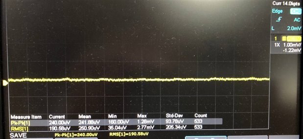

Following the rather disastrous last PCB update, I had it remade with a footprint that could take a 50uH inductor - and 10uH if I wanted to experiment.  Required a little jiggery pokery to fit the other parts around it but I also took the opportunity to rework some of the silk screen, layout, addition of a TVS on the input (D3) and re-size the mounting holes.
It’s all soldered up and back to working again thank goodness - I’m still kicking myself for misreading the 50nH inductor - with a controllable output voltage and current and nothing overheating or blowing.
So the big reveal - has this improved?  For some reason, the scope has stopped recognising the USB key that’s plugged in so excuse the photos of the screen (and the dust!!)  I suspect something wrong with the firmware but that’s a problem for another day.  These readings were measured at the output capacitor with the short-wire ground probe, AC coupled, BW limited, 1x.
1.5A / 15V
10Ohm load with no voltage or current limiting:
0.050A / 0.5V
10Ohm load with current limited to 0.050A and voltage following:
I think I’ve every reason to be happy with these results right?  Mean Pk-Pk ripple voltage of 0.288mV and a max of 1.04mV from a Vin of 24V to an output of 0.5V is worth writing home about, right?
I’ll do more testing - soak testing, voltage overshoot and so on - but I’ve described these on previous posts so I’ll only repost if I see problems, or someone specifically wants to see them.

    Great to see an update and that you are moving forwards with the project. The results look good to me, was the power supply on its maximum load? Kind regards.

    I know I said I wouldn't add more details unless significantly different, but I did get a chance to test the ripple at 15V 3A: Still pretty good in my view. At this power, the LT3081 Linear Regulators…
    DAB over 7 years ago
    You might also put the design under various loads. You will find that the noise may change depending upon what you are driving.
