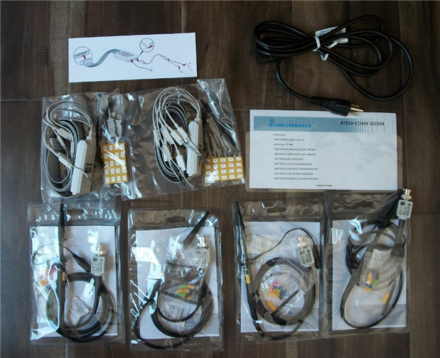

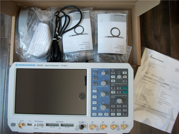

Here is what I found inside the box:  The oscilloscope, power cable, four analog probes packed in separate bags, two digital logic analyzer probes with connectors, and various documents with useful information about this product.

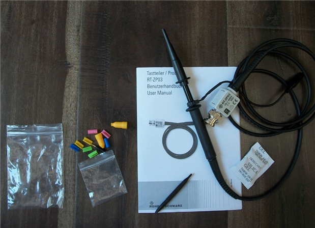

Here is a more detailed picture of the probes:image
I have found useful a "Getting Started" document and another document that listed all the options installed with the license type.
I wanted to get faster to the point when I power up and explore this oscilloscope, so I first opened the bags with the analog probes and mount the color coded indicators.

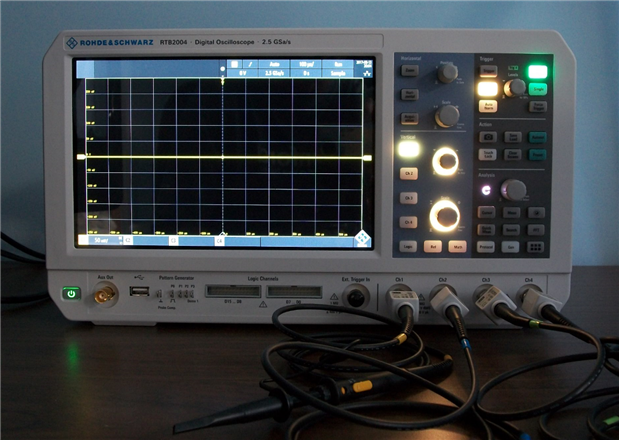

Next I connected the power cord and I pushed the "Power" button.  The oscilloscope booted very fast; I measured 15 second.  Here is a picture and a video that shows the power up:

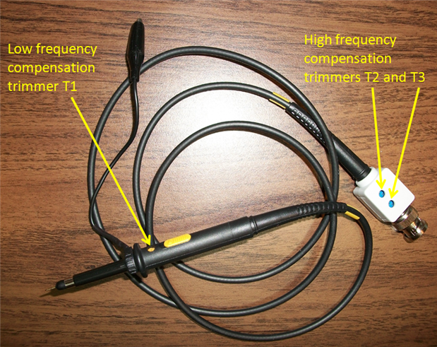

First step after power up was to calibrate the probe compensation using the small screwdriver included in the probes kit and following the instructions document that came in the probe bag.  Each probe has three compensation trimmers, one for low frequency compensation mounted on the hand-piece and two for high frequency compensation mounted on the connector:

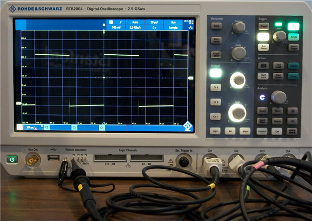

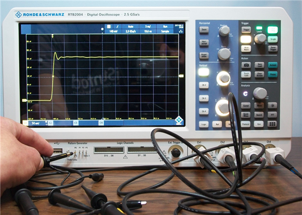

I followed the instructions in the probe manual, and I connected the probe to the 1kHz square wave output on the oscilloscope front panel.  I then adjusted the oscilloscope settings to display the 1kHz square wave signal, and I continued with compensating the low frequency trimmer, T1, on the hand piece.  Following that I compensated the high frequency trimmers, T2 and T3.  Here is a picture of the channel 1 probe connected tot the 1kHz signal generator:

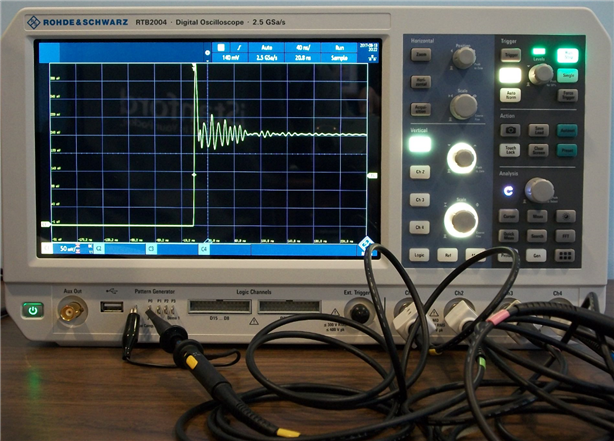

This connection worked well for the low frequency compensation; however, when I tried to do the high frequency compensation the loop inductance of the ground introduced significant ringing in the waveform, so much that it was impossible to see when the top and bottom edges are horizontal.  Here is a picture of the waveform with ringing:

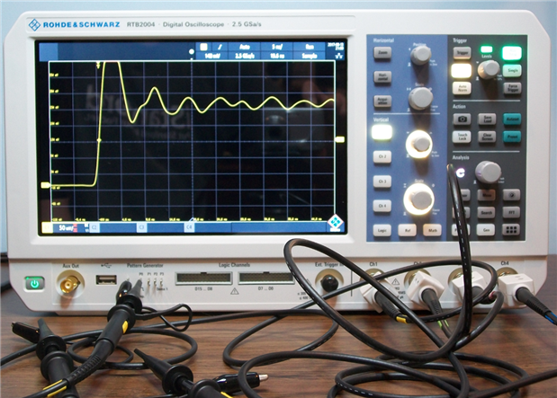

And when magnifying the horizontal time base to 5ns/div as in the instructions manual The waveform looked like this:
I then tried to understand what causes this ringing and I discovered that as I play with the probe ground wire the ringing changes.  Thus, I started to suspect the loop inductance of the ground probe as the source of this ringing.  To validate my assumption I removed the ground wire from the probe and I connected the probe directly to the pulse generator pins by touching the center signal pin of the probe to the generator output pin and the probe shield/ground directly to the generator ground.
