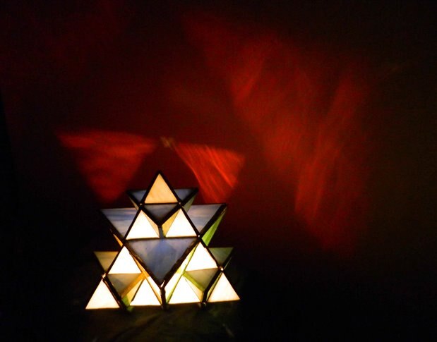

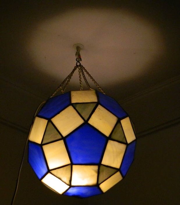

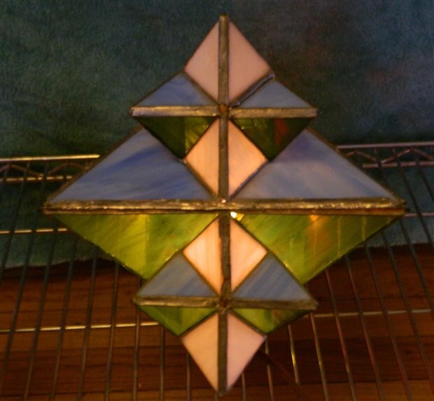

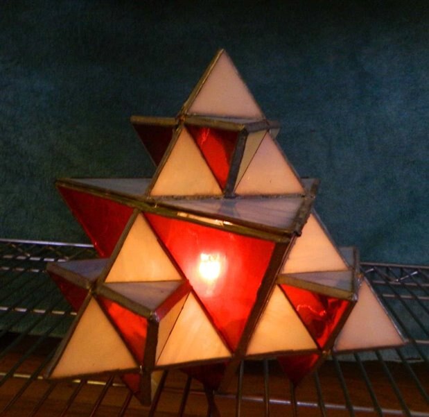

That I had my kids build when they were in grade school.  They bled mightily for the cause, I am obliged to report:
NVM the dead bugs.  Waddya want me to do, clean stuff or learn GIMP?
The kids have long since vamoosed to the edges of the continent, although they still take my calls.
So, I am left with these niggling reminders of their object superiority and fine motor skills.  I can tolerate this no further.

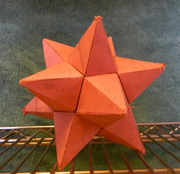

[small stellated dodecahedron]
here is a model I stole from the internet.  I have a paper model, but someone stepped on it and it is under repair.  When I am done I will update this section.  This is an icosadodecahedron, spell-checker be damned.  This is an Archimedian solid.  It is the only one whose Petri polygons are planar.  The only Platonic solid with planar Petri polygons is the octahedron.  Some argue that this makes them the most typical examples of their respective symmetry groups.image
So, I want to make three lamps:  One a model of a small stellated dodecahedron, which I will hence abbreviate 'SSD.'  Another an octahedron.  Finally, an icosadodecahedron.  The twist is that I am going with LED illumination rather than incandescent.  Per-face RGB.
