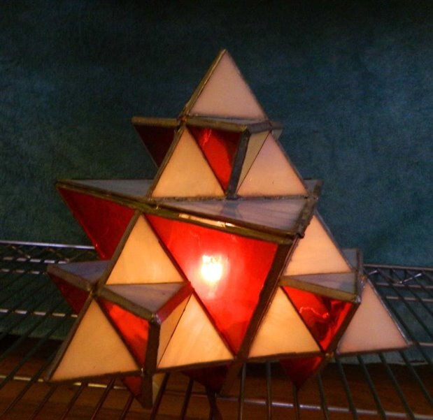

That I had my kids build when they were in grade school.  They bled mightily for the cause, I am obliged to report:

I have decided to make a pair of lamps of my own manufacture.

So, I want to make three lamps:  One a model of a small stellated dodecahedron, which I will hence abbreviate 'SSD.'  Another an octahedron.  Finally, an icosadodecahedron.  The twist is that I am going with LED illumination rather than incandescent.  Per-face RGB.
In the case of the icosadodecahedron, I plan to make a wooden skeleton.  I will make twenty triangles and twelve pentagons of wood.  They will be void in the middle.  There will be a channel routed around the periphery of the void.  I will cover the voids with white cloth.  I can take a string and a flat, round chisel and smoosh the fabric into place as wood-framed silk screens do:
I will bevel the edges appropriately and grove the edges for a popsicle-stick feather.  Then I can use vacuum-bag technique with slow-drying glue to finish the job of fabbing the skeleton.
Inside, microcontroller-controlled LEDs will shine upon the fabric.  Which brings me to why I am bring this up with you ladies and gentlemen:  I am welcome to ideas about what controller and I/O fabric to use with this project.  I am open to suggestions about what kind of LEDs to use, how to mount them, and what syndromes to employ.  Can we play a game like John Von Neumann's 'Life' here?  Can we model diffusion like a butterfly's wing?
I think I want something I can code in C++ so that I can write a Forth-interpreter for high level syndrome insertion.
I will use a little different technique with the octahedron and SSD:  I just got a nice little table-saw from Craigslist.  Boy, it is a nearly confiscatory environment out there, what with salesmen unloading samples and all. . .  I plan to saw up little strips of machineable wax to make the little isosceles triangles I will need.  They with have a little ledge that will form a lacuna for a triangle of frosted glass.  You can glue machineable wax.  It is paraffin with polyethylene (or polypropylene) dissolved in it to saturation.  This I or a proxy will sandcast with Al.  Otherwise, the idea is the same.
