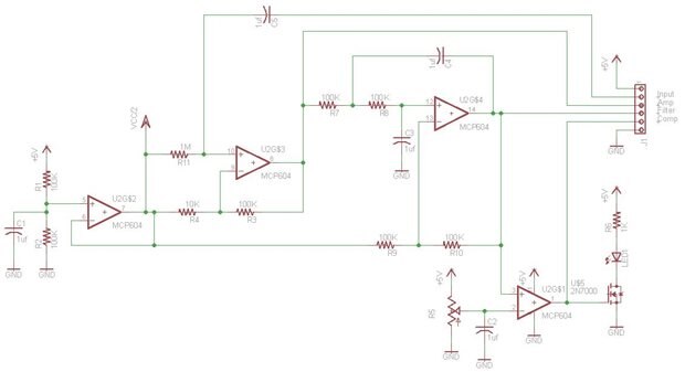

Example Circuit
Here is a simple schematic of a quad op-amp chip with 19 other components implementing standard topologies for an amplifier, a filter and a comparator.

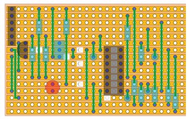

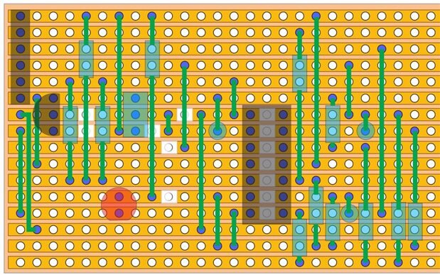

Here is top-view with transparency of what it might look like wired on a stripboard. The white squares are where the tracks get cut on the copper side. You can see it keeps point-to-point wiring clutter to a minimum.
After Jon Clift pointed out that there were connection errors, I made a new version with a bunch of changes....Incidentally, these changes could have been made on a real card without any change to the final look.
Here is the old one for those who are curious:

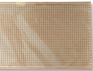

Newark carries lots of different sizes of stripboard or VeroBoard and they even carry a tool to cut the trackstool to cut the tracks.

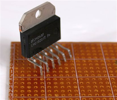

Stripboards can even connect some difficult to connect parts like this big H-bridge that do not use 0.1" pitch for their pins - this one just needs to be placed at 45 degrees and each pin ends up on a different track, assuming you cut the appropriate tracks between pins.

    I can spot two errors in your stripboard layout, if anyone wants to try practising their fault-finding skills. You were lucky with the transparent red and blue tape: the first company I worked for was…

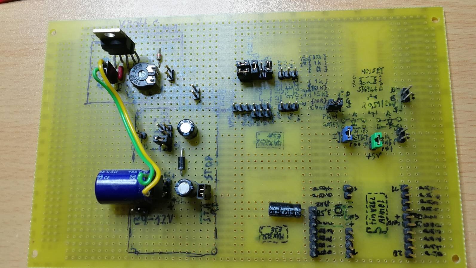

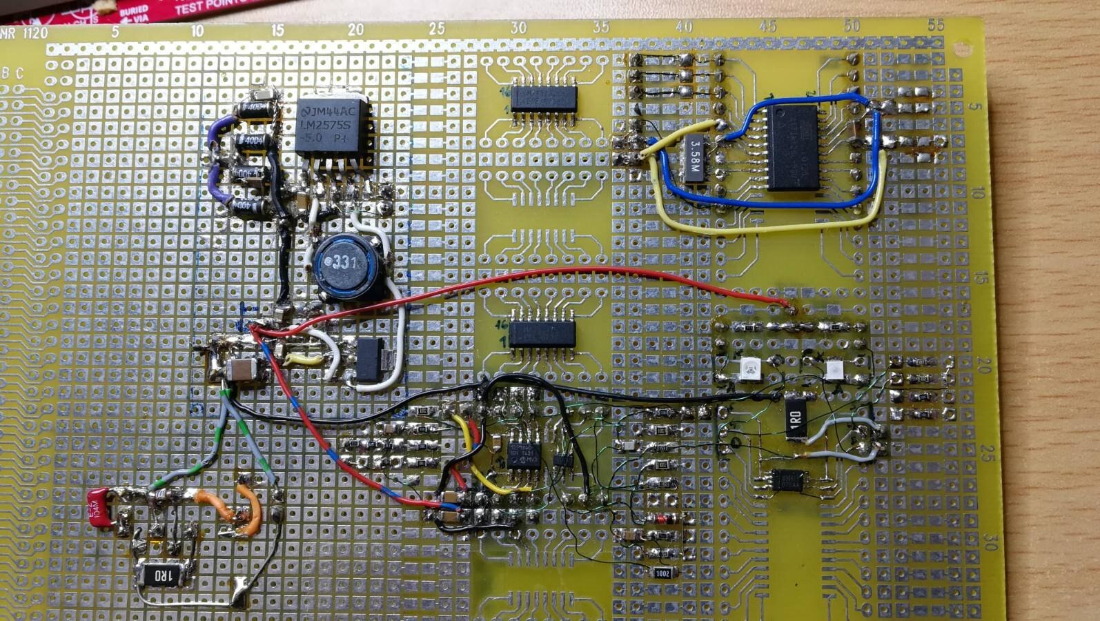

    I have separated the circuit into sections: the AC / DC source on the left, the application circuit in the middle and on the right side.
    The through-hole components are on top, the SMD's are on the bottom.
    This can be clearly seen in the photo, for example: I had to solder a lot of bypass capacitors.
    Left-top: DC/DC under it a LDO, middle a the µC and OPAMP, right the dual-MOSFET with LEDs as well some components.
    Right-top: for an other application a µC, middle-top: RS-drivers.

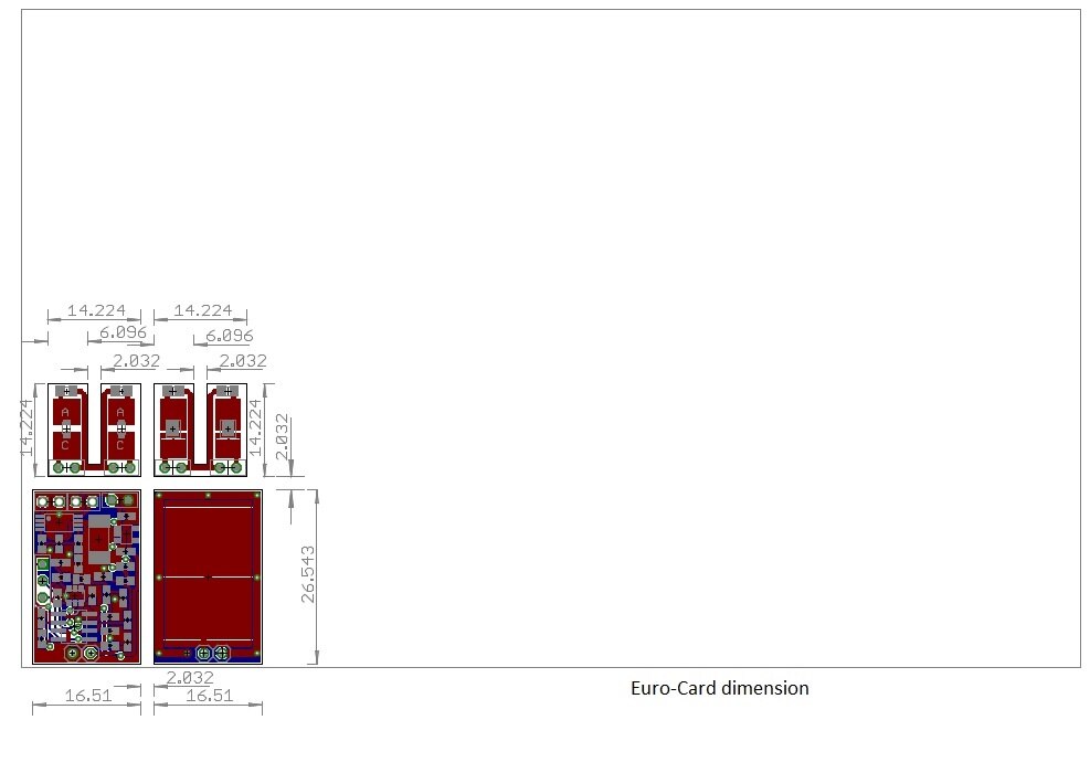

    The original dimension of the circuit with the µC, OPAMP and the LEDs (controller-, touch-sensor-, LED-boards).

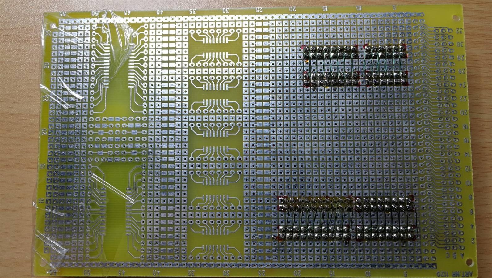

    Pro to the pad protoboards:
    a.) I am already building the circuit as I build it on an etched circuit board.
    b.) The wires are arranged in such a way that they form the conductor tracks, two-sided, three-sided, etc ..
    c.) I can easily remove the unused pads with a cutter knife. I do it like this, I lift out a little with the tip of the knife and pull the pad down with the side cutter. If it comes off, I'll just scrape it off; is very easy.
    This frees up space to improve the electrical properties of the board.
    There is also no longer any risk of short circuits because there is enough space around the solder joint.
    I use different methods to lay the wires, jumper wire, thread wire (with or without thread combs), component wire, and lay them like a conductor path.

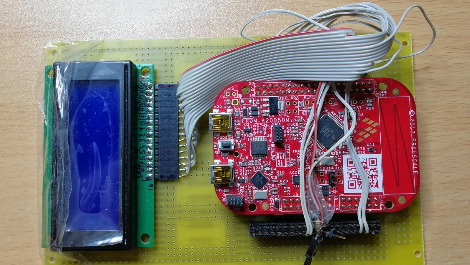

    This proto-PCB is compatible to the Arduino footprint. Well, nice .....
    - Everything is built up just like an etched circuit board.
