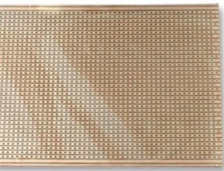

Strip board implements this paradigm by including all the traces on the bottom of the card running in the same direction and has all the vias pre-drilled to allow jumper connections across traces. In practice, through-hole components bridge between traces, so very few jumpers are actually needed. Basically all nets have a horizontal trace or section of a trace on the bottom of the card and all components are installed vertically between these nets. It can end up looking as neat and almost as dense as a custom double-sided PCB. It takes some planning to efficiently use the horizontal traces on the bottom and minimize vertical jumpers, but the result can be a very clean circuit card. For example the power and ground nets are generally horizontal traces that run the length of the card. Many components directly connect to these  bus bars. Also if there are busses involved they are already built into the strip board.

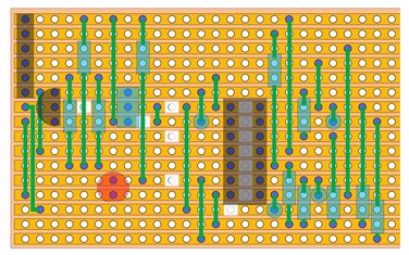

Individual nets may only have a few components connected, so they only need to occupy a short trace on the copper side. The trace is cut using a spot-face cutter so that the next section of the same trace can be used for another net.
Example Circuit

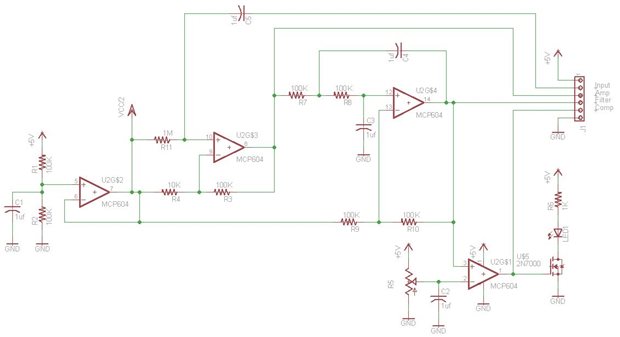

Here is a simple schematic of a quad op-amp chip with 19 other components implementing standard topologies for an amplifier, a filter and a comparator.

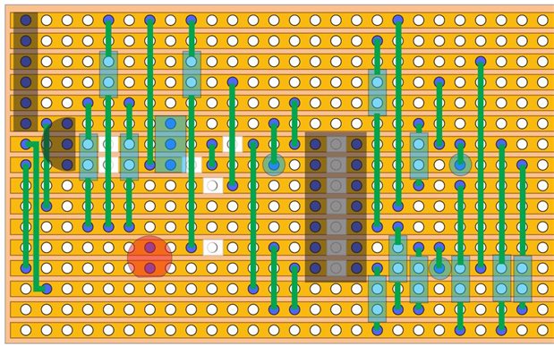

Here is top-view with transparency of what it might look like wired on a stripboard. The white squares are where the tracks get cut on the copper side. You can see it keeps point-to-point wiring clutter to a minimum.
After Jon Clift pointed out that there were connection errors, I made a new version with a bunch of changes....Incidentally, these changes could have been made on a real card without any change to the final look.
Here is the old one for those who are curious:

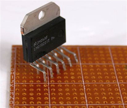

Stripboards can even connect some difficult to connect parts like this big H-bridge that do not use 0.1" pitch for their pins - this one just needs to be placed at 45 degrees and each pin ends up on a different track, assuming you cut the appropriate tracks between pins.

  • jc2048
    jc2048 over 5 years ago +9
    I can spot two errors in your stripboard layout, if anyone wants to try practising their fault-finding skills. You were lucky with the transparent red and blue tape: the first company I worked for was…

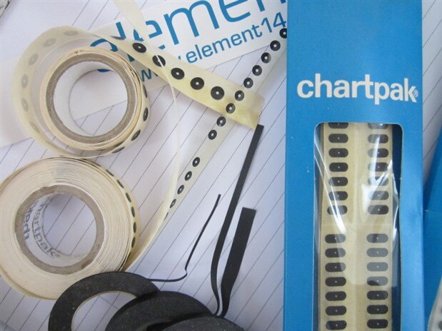

    You were lucky with the transparent red and blue tape: the first company I worked for was really cheap and we only had black crepe tape to work with. Did you get to use transfers like these for the DIL chips, or did you use the circular component-lead pads?

    dougw over 5 years ago in reply to jc2048
    Yes we had a number of different pad decals in black as well as black tape for when both sides had copper. I still have a box of tape somewhere - will have to dig it out.
    Yes the layout is not tested and is not optimized - it is just to provide some insight into what the final layout might look like. One missed track cut stands out.

    jc2048 over 5 years ago in reply to dougw
    I think there's a second missed track cut.

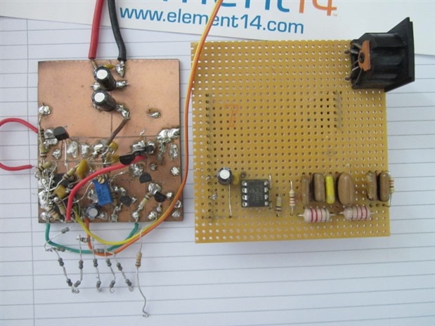

    To answer the your original question, I will sometimes prototype on stripboard, but I like much more building ad-hoc on raw pcb material cut into islands with a craft knife.
    The stripboard example, on the right, was an ADC with a simple, passive reconstruction filter. I chose the stripboard because there are headers underneath that plug into a Brevia 2 FPGA board and it would have been very messy to try and do that without the neat 0.1" grid of holes. The pcb board example, on the left, was for one of my 'experimenting' blogs, can't remember which one, and the circuit grew and developed (in 3 dimensions - there's an upside-down chip in the bottom-left corner) as I went along.

    I have the same preference. Cladboard as first choice. stripboard (with or without lanes) when using headers.
    I prefer the simple stripboards (long lanes, all pads in a lane connected) more than the ones with elaborated trace schemes.
