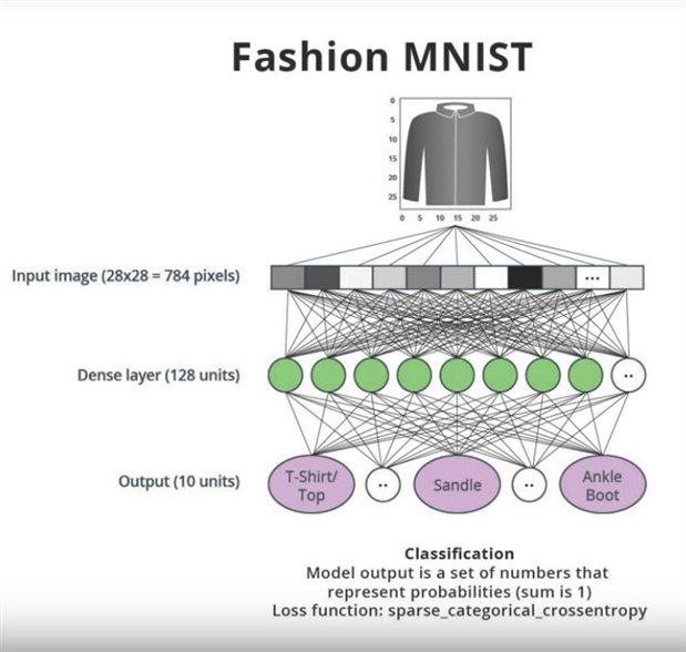

In the 2nd post and 3rd post simple image recognition was explored using a training dataset of 60,000 images and a test dataset of 10,000 images.  The dataset contained 10 classes of clothing and had a single dense layer.  An activation function called ReLU was used to introduce nonlinearity.
An accuracy of 87% was obtained on the test dataset using a single dense layer.  In this post the concept of convolutional neural networks is introduced with the objective of improving accuracy.

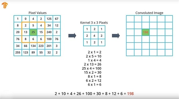

The last point is the source of power - the filters are learned during the training process.  Typically filters are specified to be 1x1, 3x3, 5x5, and up to 7x7 pixels with larger filters used on larger images.  Remember that grey scale images are represented as two dimensional arrays in a computer.  In the following simplified example from the Udacity TensorFlow training a 3x3 filter is applied to a 6x6 pixel image.
The convolution is working on the pixel highlighted in green at left and the 3x3 filter occupies the space inside the orange square.  The filter or kernel is shown in the middle diagram.  Mathematically it multiplies the value in the kernel times the value in the corresponding pixel in the image.  So, for example the upper left pixel in the area being convolved (2) is multiplied by the value in the filter (1).  This is repeated for all pixels as shown beneath the kernel and all the values added up.  The resulting value is 198 and this replaces the original value of 4.
The filter continues sliding across the image until all pixels are convolved.  The pixels on the edge are a special case and usually "padded" with zeros so that the data is not lost.

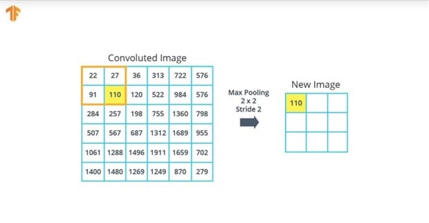

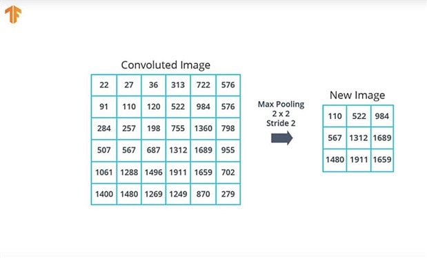

Max Pooling is one of several methods of reducing the size without losing important information.  A window of user specified size, e.g. 2x2 is applied to the convolution output and the max value in the window selected.  It is then slid by the stride length to the next area to be pooled.  Using the convoluted example from above:
The convoluted image is reduced from 6x6 to 3x3.  Only the max value in the window is used for the new image as shown below.

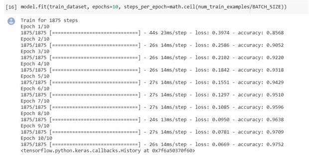

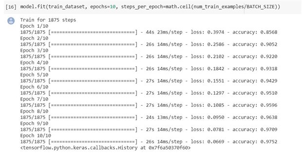

The model is compiled and trained as before but using 10 epochs which results in (60,000 x 10) 600,000 examples as shown below.
This results in 97.5% accuracy. compared to 89% previously.  Each epoch takes 26 to 27 seconds after the initial 44 seconds.

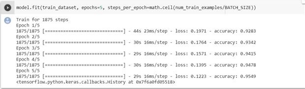

In an attempt to further improve I added an additional convolutional layer with 128 images and an additional layer with 128 neurons to the model and trained for 5 epochs as shown below.
Accuracy from the training set is 95.5%.  Below is the test results.
Surprisingly, the results are not as good as the initial model (91.3% Vs. 92%).
