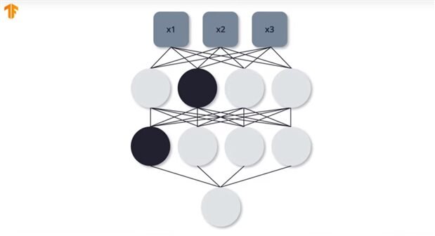

Dropout
During training the neural network adjusts weights and biases to minimize the loss function.  This can result in certain neurons obtaining large weights relative to other neurons which causes them to dominate the network.  As a result the neurons with smaller weights don't get trained much.  Dropout is a way to avoid this by randomly turning off some neurons in the network during training.  This allows the other neurons to receive more training.  For example, in the example below taken from the Udacity training two neurons (shown filled with black) are randomly turned off, one in each row during an epoch.  In subsequent epochs this random selection is continued.
Feed forward and back propagation continues without using the neurons that have been turned off.  This helps avoid overfitting and the network utilizes all the neurons more efficiently.

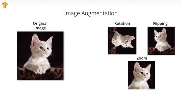

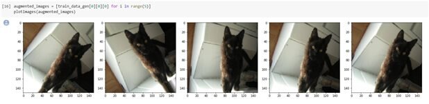

Augmentation
It is desirable for the model to recognize the subject no matter the size, position or where it is in the image.  In a large enough dataset all of this information may be included in the training dataset and it will be less likely to overfit.  If not, augmentation is a way to add examples with different angles, size, orientation, etc. which allows it to generalize better.
For example, TensorFlow can modify or transform an image as shown in the example below.
Example snippets of code and the results are shown below.

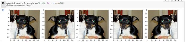

Flipping Images
image_gen = ImageDataGenerator(rescale=1./255, horizontal_flip=True)
train_data_gen = image_gen.flow_from_directory(batch_size=BATCH_SIZE,
                                               directory=train_dir,
                                               shuffle=True,
                                               target_size=(IMG_SHAPE,IMG_SHAPE))

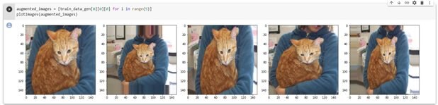

Rotating Images
image_gen = ImageDataGenerator(rescale=1./255, rotation_range=45)
                                               shuffle=True,
                                               target_size=(IMG_SHAPE, IMG_SHAPE))

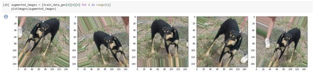

Zoomed images
image_gen = ImageDataGenerator(rescale=1./255, zoom_range=0.5)
                                               shuffle=True,

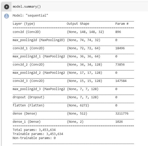

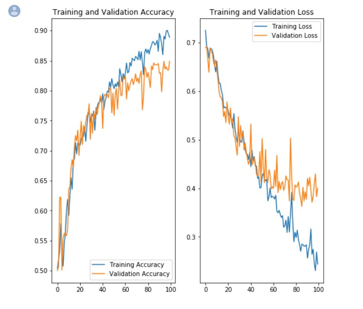

The convolution and compiling of the model remains the same as the previous example.  The model definition remains the same as the previous example except that a dropout of 0.5 (50% of the values coming into the dropout layer are zeroed) is specificied just before flattening and the dense layers.
model = tf.keras.models.Sequential([
    tf.keras.layers.Conv2D(32, (3,3), activation='relu', input_shape=(150, 150, 3)),
    tf.keras.layers.MaxPooling2D(2, 2),
    tf.keras.layers.Conv2D(64, (3,3), activation='relu'),
    tf.keras.layers.MaxPooling2D(2,2),
    tf.keras.layers.Conv2D(128, (3,3), activation='relu'),
    tf.keras.layers.Dropout(0.5),
    tf.keras.layers.Flatten(),
    tf.keras.layers.Dense(512, activation='relu'),
    tf.keras.layers.Dense(2, activation='softmax')
Below is the model summary.
Remember that previously, without augmentation or dropout, the training accuracy was 100%  (overfit) at 100 epochs and the validation accuracy of 75% was achieved in less than 20 epochs.  Adding augmentation and dropout results in the following.
Training accuracy is now about 88% (Vs. 100% before) due to the use of image augmentation.  But the image validation has improved to 84% (Vs. 75% before), a significant improvement.  According to the course training video, training should probably cease around 60 epochs which is where the curves for the training and validation start to diverge.
