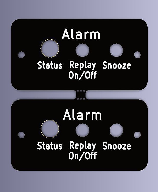

Two boards have been populated and tested now and everything seems to be working.  This update will cover thoughts on the PCB, faceplate design for the enclosure, and an update on the firmware.
I am satisfied with the PCB for the most part now but will decrease the drill hole size for the LED as the fit is a little loose.  Three different buzzers were tested and while all were satisfactory the one with the highest pitch seemed the most annoying and so that is the one I will use.
Here is the design for the enclosure face plate:
I had an extra dAISy blank plate for the enclosure and made a prototype with my drill press to make sure the dimensions were correct.  The plates will be fabricated by the PCB manufacturer.
The firmware features have now been tested individually but not completely integrated.  My chosen process is to add features one at a time and test before moving on.

    genebren over 8 years ago +5
    Frank, What a clever idea, using a PCB as a face plate. I have struggles in the past, trying to come up with an affordable and clean face plate for products, so this is a real eye opener. How cool, in…
  • three-phase
    three-phase over 8 years ago +5
    I too hadn't thought of using a PCB for a faceplate. In the past I have printed out the faceplate onto paper and then covered with a clear stick plastic sheet available from hobby shops in the UK, as per…
    mcb1 over 8 years ago +3
    Hadn't thought of using a PCB house to make face plates. Great idea and lends itself to lots of possibilities. Mark

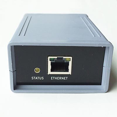

    shabaz over 8 years ago in reply to fmilburn
    Hi Frank,
    That's great to know, thank you for checking this out!
  • fmilburn
    fmilburn over 8 years ago in reply to shabaz
    Hi shabaz,
    I asked my friend who first showed me the PCB face plate trick if he had ever made them without a ground plane - he has experience with a commercial product that used them in largish quantity.  He told me that most of his were also with a ground plane but that he had made them without and did not experience a problem with manufacturers.  Similar to my experience, his faceplates also had a relatively small area.
  • fmilburn
    Hi Shabaz,
    The ones above have a copper plane below a black mask but I did do a design once that did not have copper on either side - it was with Elecrow if I remember correctly.  However it was fairly small in size - 30 x 60 mm and was only 10 boards and they didn't complain.
    Hi Frank,
    I had a question, if you want an unshielded design (I want unshielded, for a particular use-case), are the board manufacturers ok with making front panels like that, with no copper pour on either sides?
    I'm guessing it uses up a lot of chemicals during the etch process, I was just wondering if they complain about that or not. Are yours with copper plane underneath the black solder mask, or no copper?
  • fmilburn
    Thanks!  I cannot take credit for originating the PCB idea but have used it a couple of times now.  The dimensional tolerances are good and different internal shapes are possible.  This photo below is from an Ethernet connected microcontroller I put together a while back.image
