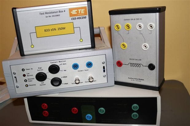

    I too hadn't thought of using a PCB for a faceplate. In the past I have printed out the faceplate onto paper and then covered with a clear stick plastic sheet available from hobby shops in the UK, as per the resistance test box, or I have reversed the image and printed onto a transparent film and then stuck that onto the plate as per the other boxes.
    The bottom box was a black plastic faceplate, so I tried printing yellow onto the transparent film, but that one didn't turn out too good.
    Look forward to seeing a fully built AIS Alarm.
