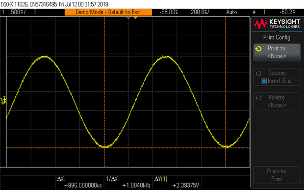

Lab 1 teaches manual measurement of a sine wave on the Keysight using the built-in training wave forms.  Since the other scopes do not have built-in wave generation, their probes measured the output from the Keysight.  Measurement on all of the scopes was equally easy for the Sine wave.  A screenshot was taken from each oscilloscope and posted below along with comments.
Keysight Screenshot
The Keysight screenshot is clean and easy to read as is the display.  After getting used to the placement of the horizontal controls which differs from the Rigol and Siglent I find it easy to use.
Rigol Screenshot
I find the Rigol screen a bit busy but easy to set up and use.
Siglent Screenshot
The display of the Siglent is the same physical size as the other two but has lower resolution and the vertical and horizontal cursors cannot be set and seen at the same time.  Only the horizontal cursors are set in the screenshot above.
Summary:  All are acceptable for entry level use but the Keysight shines and the Siglent lacks the ability to display horizontal and vertical cursors at the same time.  The control knob feel is best on the Keysight.

Lab 10 demonstrates the many automatic parametric measurements that can be done on a digital oscilloscope.  A repetitive pulse with ringing is set up on the training signals.  Up to four parameters can be displayed at the bottom of the scope along with cursors indicating the last one entered.  The following screenshot shows top, base, rise, and fall at the bottom of the screen for the Keysight with cursors framing the fall time.
A quick capture of all the parameters can be done with a “snapshot” that tends to overlay the signal since it is placed in the middle of the display.
It would be nice if Keysight moved the summary table off of the center of the display.
Greater flexibility is available on the Rigol for individual parameters.  There is also the ability to do a quick capture of all signals and the signal can be placed such that the information does not obstruct it. However, I find the information somewhat harder to read due to size and layout.
Of course the Siglent has its own way of doing things.
Summary: All of the scopes do automatic parametric measurement.  It would be nicer if the Keysight did not place the full summary directly in the middle of the screen.  I prefer the layout of the Keysight information in general though that is subjective.
